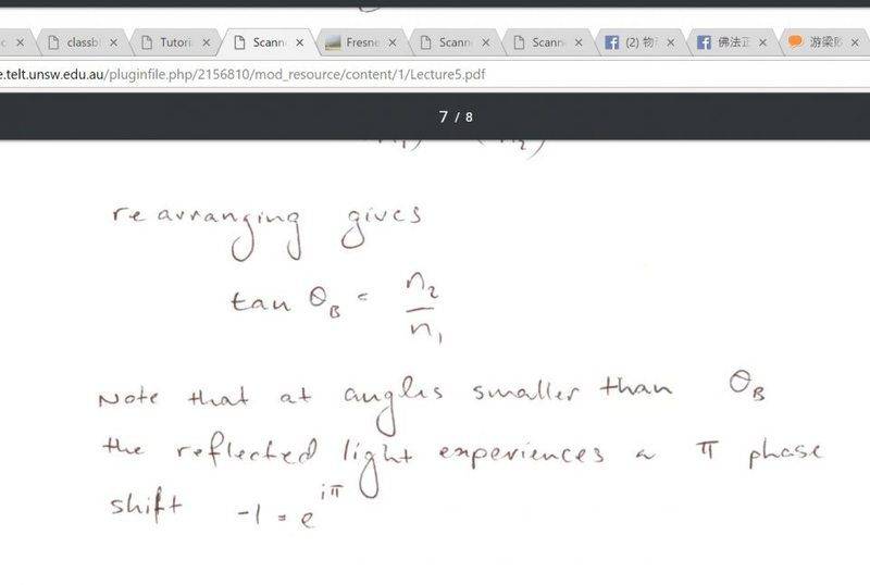

i have question for TM polarization.
i don't understand why if the angle < brewster's angle,then the reflected light will experience an pi phase shift?
can anybody explain why?
Take a look at these equations, especially ##r_p## which is the (complex) reflection coefficient for TM polarization. In particular, you will be interested in the so-called internal reflection, that is when ##n_2 < n_1##.
