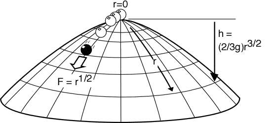

I see some skepticism on my reply. The example is discussed in pitt.edu and stanford, quoting below the bottom of section 4.1
stanford said:
Finally, an elegant example of apparent violation of determinism in classical physics has been created by John Norton (2003). As illustrated in Figure 4, imagine a ball sitting at the apex of a frictionless dome whose equation is specified as a function of radial distance from the apex point. This rest-state is our initial condition for the system; what should its future behavior be? Clearly one solution is for the ball to remain at rest at the apex indefinitely.
Figure 4: A ball may spontaneously start sliding down this dome, with no violation of Newton's laws.
(Reproduced courtesy of John D. Norton and Philosopher's Imprint)
But curiously, this is not the only solution under standard Newtonian laws. The ball may also start into motion sliding down the dome—at any moment in time, and in any radial direction. This example displays “uncaused motion” without, Norton argues, any violation of Newton's laws, including the First Law. And it does not, unlike some supertask examples, require an infinity of particles.
Of course, Dale's posts about physical systems not being mathematically perfect are valid points. A physical system cannot be perfectly symmetrical since there are always moving atoms or forces applied by random objects. Nothing stands still in reality. So the above example is a classical mathematical one, not one composed of real quantum fundamentals with no exact state.

Why was Norton so specific about the function of the slope of his hill? It seems that the only important part of it is that it is locally level near the top, which yes, prevents the ball from ever reaching the apex. Even a ball on a pointed cone would never reach the apex.
So what if we devised a force map that was zero at the apex but some finite nonzero value everwhere else. I can think of some physcial situations that meet this (such as a pair of slippery shallow cones balanced point-to-point), so why didn't Norton use something like that as his example? I suppose I'd have to digest his reasoning to see why he made his choice of that particular cone. I think it has a property of always being wider than a parabola so that the ball sliding on it can never leave the surface.
In the time reversed scenario (on a Norton dome) the ball does reach the apex and stops at the apex in finite time. That is precisely the point. If the ball reaches the apex and stops for a time, it can re-start and fall back down at any time, and in any direction, non-deterministically, without ever violating Newton's laws.
Norton chose the shape he did so that he could get the central force law that yielded a differential equation where the boundary conditions at t=0 are inadequate to constrain the solution. Many years ago in my first course on differential equations we were exposed to such a situation. I cannot now remember that equation.

Based on the picture which gives height as a function of radius, one can compute mechanical energy as a function of radius, and from that get the kinetic energy. So I computed the time needed to go 3/4 of the way to the center: R=16, energy is 16**(3/2) = 64, so speed is proportional to 8 (I'm ignoring the constants, working only with proportions). Go from there to R=4 which is some amount of time proportional to 1.5. Going from there to 1 you get energy 8, speed 2.83 which takes 1.06 units of time, a ratio of sqrt(2), so the next one is going to take 0.75 units of time.
OK, that series converges to a finite number, so I stand corrected on that. My computation assumed the 'ball' is actually a point mass. Not sure if it matters, so perhaps it should also be considered for the case of a large ball sliding up there.
Totally agree, and that was the gist of my first post in this thread.
