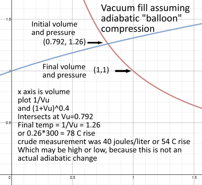

To summarize, the problem is what will happen to the heat generated by allowing the atmosphere to fill a container initially holding vacuum.
The proposed solution by MIT is that the answer is that work equal to Po*Vo is added to the container.
There are 2 errors in the solution and a more general error in the sense that treating this like a closed system suspended in mid air with no container is at best approximate.
From this they arrive at a rise of 200 C, computed by "gamma". However, they apparently do not use the correct value of Gamma for air, which is 1.4. Assuming ambient is 300 Kelvin, the final value of the temperature would be 420 kelvin, or a 120 C rise. The same as you get from adding 100 Joules to a liter of air, 120 C rise.
They draw an imaginary line or balloon around a volume of air equal to the volume of the container, and assume adiabatic compression of this air into the container. This is not correct, since both heat and air can freely pass the imaginary line (meaning it is not adiabatic compression), but its not a bad upper bound.
They also assume the volume of air outside will equal the volume of air inside. That is, once the container opens, the initial volume of the system is 2*Vo, initial pressure 1/2Po, and final volume is v0, final temperature X*To where X is greater than 1. This is very incorrect.
As the problem is stated, the initial volume of the imaginary balloon is unknown. Although since compression heating is happening, it must be smaller than Vo, because the temperature will increase. So taking po as 1, the final density must be 1/X. And since initially the temperature was also 1 on a relative scale, the initial unknown volume was also 1/X. Let initial temperature, volume, density, and pressure all equal 1 (relative scale) for clarity. Stating the problem in terms of Vu for Volume unknown we know:
Initial volume = 1+Vu
Final volume = 1
Volume Ratio = 1/(1+Vu)
Beta = gamma -1 = 1.4-1 = .4, the exponent of the energy curve, from integrating the pressure curve.
Heat Ratio Hr= (1/1+Vu)^-0.4, simplifying = (1+Vu)^0.4
Initial density = Vu/(1+Vu)
Final density = Vu
Initial Temperature = 1
Final temperature = 1/Vu
finally, ending temperature is both 1/Vu and 1*Hr or (1+Vu)^0.4:
1/Vu = (1+Vu)^0.4
See graph for solution, Vu=.792, Temp final = 1.26*T initial or 78 C rise for 300 Kelvin initial.
I mentioned this was an approximation, essentially it assumes there is a weightless, perfectly insulating balloon surrounding the starting point. But since its imaginary, this depends on an imaginary balloon with 1 atmospheric pressure on one side and 0.6-ish atmosphere on the other. Also, while the total volume is collapsing at the speed of sound, heat is also escaping at the speed of sound. Also, realistically initial pressure outside the imaginary line must be less than 1,and so some of the work done is done on air outside the imaginary line. The "solution" system cannot be accurately analyzed as a real system, as it is closed to neither heat nor mass.
The 78 C rise corresponds to a 65 joule per liter energy. So this model says 35 joules of every 100 does not reenter the volume. The very crude experiment "measured" 40 Joules, or a 54 C rise. So I'm actually pleased at that. A non-adiabatic compression would yield lower temperatures. The experiment shows your mileage may vary, which I expect is also true if the opening were varied from a pinhole to a full square meter. Still not sure how to accurately calculate this, but I finally have a model and measurements that are predicting similar quantities of heat inside the volume.
And for all the carping about MIT's inaccurate model, I must thank them for helping me get a handle on a reasonably accurate method to calculate at least an upper bound.
