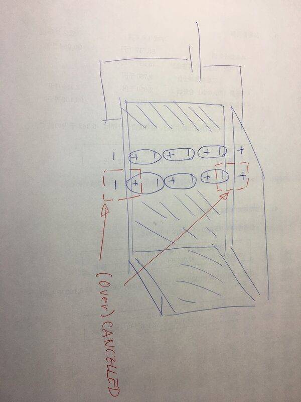

Please find an attached figure to show "cancel" I mean in post #14. Dielectric is also insulator, touching condenser plates.

anuttarasammyak said:
Please find attached figures to show "cancel" I mean in post #14.
That's fine as an intuitive picture of it but how is that 'cancellation' any different from the same +- patterns that you have drawn all over the dielectric? Wouldn't you expect the gradient of the potential 'within' each molecule to be the same as the gradient of the potential between them? If it were not, there would be movement of charge to make it so.
In terms of field, you have a situation with constant field through the dielectric and Zero field within the conductor. It's just a matter of how 'micro' you want to go in describing the transition. Also, a real situation will have gaps between the two surfaces with a few points of contact. In those gaps you would have Air? or even a Vacuum?. Where would your "cancellation" be there?
Likes feynman1
It's of course not completely cancelled. Since here the battery is connected to the capacitor you have a given voltage difference across the capacitor. That voltage difference leads to a charge ##\pm Q## on the plates with $$Q=C U = C_{\text{vac}} \epsilon_{\text{rel}} U,$$
i.e., you need more charge on the plate to get that voltage difference in the steady state than if the capacitor is filled with vacuum (because ##\epsilon_{\text{rel}}>1##). This is due to this "cancellation of charges" by polarization of the dieelectric.
