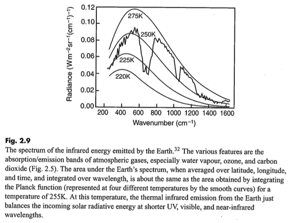

The lower atmosphere absorbs green house gasses at certain frequencies, thus the Earth emits black body radiation at the temperature of -9F (-23C). But there are frequencies that CAN jump straight to space. Why don't they raise the BB temperature?
I have been searching for the answer yet – as I'm here – didn't find it.
The current model of climate warming says the lower parts of Earth's atmosphere don't allow the IR radiation to escape freely to the outer space because the GH gas molecules keep absorbing it virtually as soon as it's been emitted by another GH gas molecule.
That means the Earth can give out the excess heat by BB radiation only at higher altitudes (5+km), where there is no longer enough GH gasses present to block it. Also, the temperature there is much lower, thus there the BB radiation is less energetic, corresponding to the temperature of -9°F (-23°C).
But what happens to the near-surface IR radiation at the frequencies that can NOT be absorbed/emitted by the GH gasses? Shouldn't it raise the Earth's actual BB temperature?

It does raise the BB temperature, to -23° C.

I'm not sure I understand the question. The Earth is not a perfect blackbody. The emitted spectrum only follows approximately that of a black body, so what role does it play if there are peaks at certain IR frequencies due to the transparency of the atmosphere?
Edited to add this figure from F. W. Taylor, Elementary Climate Physics (OUP, 2005)

Hot material radiates across the IR spectrum with a Planck spectrum distribution.
https://en.wikipedia.org/wiki/Black-body_radiation#Spectrum
Some of that will be absorbed by GH gasses, while other wavelengths have a chance of escape into space. The air and GH gasses, may be transparent to those wavelengths, but aerosols such as clouds, pollutants, dust and pollen are not, so will be heated.
https://en.wikipedia.org/wiki/Aerosol#In_the_atmosphere
Once those aerosol materials are heated, they will lose heat by conduction to the air, or radiate the thermal energy, again with a Planck distribution. For that reason, wavelengths that might escape, can be converted by aerosols, to wavelengths that will be absorbed by GH gasses.
