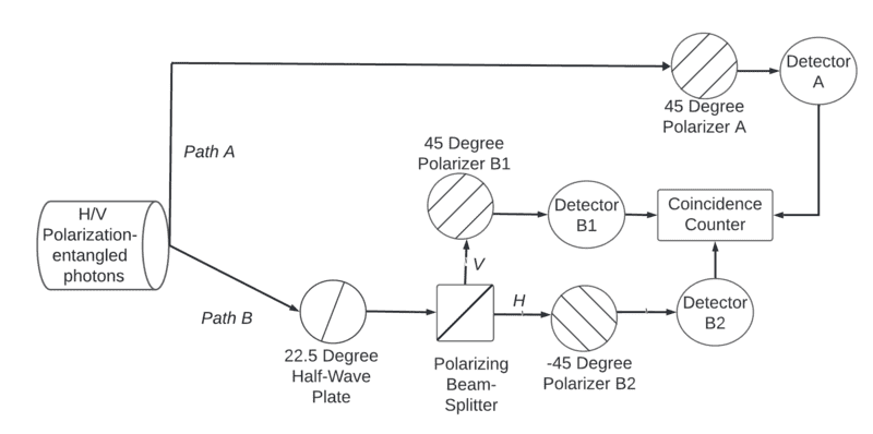

A hypothetical experimental setup is depicted, can you help me understand what would happen in the scenarios described here?
Please consider the depicted setup. We assume that the source is producing only H/V polarization entangled photon pairs (which is separately confirmed prior to the experiment).
Scenario 1) First suppose that the depicted 45 Degree Linear Polarizer A is absent. Photon B's polarization is in H/V superposition to start, then after going through the half wave plate oriented at 22.5 degrees -> (V)ertical polarization becomes (D)iagonal and (H)orizontal polarization becomes (A)ntidiagonal. The Polarizing Beam Splitter transmits V and reflects H. If A and D encounter the PBS they are each randomly converted and routed towards either the H or V path. Detectors B1 and B2 should register roughly the same number of photons after reducing to coincidences with Detector A.
Scenario 2) As depicted, the 45 Degree Linear Polarizer A is present. Photon A encounters the diagonally (45 degree) oriented linear polarizer in Path A. Since the photons in Path A and Path B are orthogonally polarized and entangled, when Photon A goes through the diagonal polarizer then we know that Photon B is (A)ntidiagonally polarized, and the particles are thereafter no longer entangled. If Photon B is A polarized when approaching the HWP oriented at 22.5 degrees, then it becomes (H)orizontally polarized. H polarization is reflected through the PBS. As a result, only Detector B1 registers impact (after filtering to coincides along Path A using the coincidence counter).
Have I described this correctly? If so, could the length of Path B change the outcome?
I'm familiar with the Quantum Eraser experiment and how in that experiment they showed that the length of the paths did not matter, but I think that post-selection filtering used to reduce the diffraction pattern to an interference pattern could possibly explain what seems to be retrocasual effect. Since the setup depicted here doesn't use interference patterns I think the same explanation would not apply.
@vanhees71 @gentzen an extension of my previous question :) Thanks in advance!

I don't think the figure is correct because you have pairs of photons, so they shouldn't go through a beam splitter. Path A and Path B should start independently from the source in opposite directions. But that doesn't really matter.
Let's write it out. The single-photon states are
\ket{H},\quad \ket{V},\quad \ket{D} = \frac{1}{\sqrt{2}} \Big( \ket{H} + \ket{V} \Big),\quad \ket{A} = \frac{1}{\sqrt{2}} \Big( \ket{H} - \ket{V} \Big)
The initial two-photon state is ##\ket{\psi} = \frac{1}{\sqrt{2}} \Big( \ket{HV} - \ket{VH} \Big)##
The action of the HWP on single-photon states is
\hat{U} \ket{V} = \ket{D}, \quad \hat{U} \ket{H} = \ket{A}
therefore
\begin{align*}
\hat{U} \ket{A} &= \hat{U} \frac{1}{\sqrt{2}} \Big( \ket{H} - \ket{V} \Big) \\
&= \frac{1}{\sqrt{2}} \Big(\hat{U}\ket{H} - \hat{U}\ket{V} \Big) \\
&= \frac{1}{\sqrt{2}} \Big(\ket{A} - \ket{D} \Big) \\
&= - \ket{V}
\end{align*}
(so there is something wrong in what you wrote for scenario 2, but again it is not a big deal).
Scenario 1:
After the HWP, the two-photon state is
\frac{1}{2} \Big( \ket{HH} + \ket{HV} - \ket{VH} + \ket{VV} \Big)
That gives us equal probabilities for all cases, hence equal probabilities that detectors B1 and B2 will click (Detector A will click each time). So your result is correct.
For Scenario 2, lets divide it in two cases:
1st case: Path A is longer than path B
Photon B encounters the HWP before anything happens to photon A, so we have the same state as above,
Photon A then reaches the polarizer. We are interested in the cases where it passes through it, resulting in a click in detector A. This corresponds to measuring photon A in state ##\ket{D}##, so we have
\begin{align*}
{}_A\bra{D} \frac{1}{2} \Big( \ket{HH} + \ket{HV} - \ket{VH} + \ket{VV} \Big) &\propto
\Big( {}_A\bra{H} + {}_A\bra{V} \Big) \Big( \ket{HH} + \ket{HV} - \ket{VH} + \ket{VV} \Big) \\
&= \Big( \ket{H}_B + \ket{V}_B - \ket{H}_B + \ket{V}_B \Big) \\
&= \ket{V}_B
\end{align*}
Photon B is now in V polarization (not H as you write), so only detector B2 will click when detector A clicks.
2nd case: Path B is longer than path A
Photon A encounters the polarizer before anything happens to photon B, so we have a detection event similar to above, but applied to the initial two-photon state:
\begin{align*}
{}_A\bra{D} \frac{1}{\sqrt{2}} \Big( \ket{HV} - \ket{VH} \Big) &\propto
\Big( {}_A\bra{H} + {}_A\bra{V} \Big) \Big( \ket{HV} - \ket{VH} \Big)\\
&= \Big(\ket{H}_B - \ket{V}_B \Big) \\
&\propto \ket{A}_B
\end{align*}
Photon B now has polarization A. As shown above, the HWP will transform this polarization into V, so again only detector B2 will click when detector A clicks.
As you can see, the order of the operations have no influence on the result.

I'd rather write for the latter state (ignoring the normalization factors)
$$|D \rangle \langle D| \otimes \hat{1} (|HV-VH \rangle) \propto |D V \rangle-|D H \rangle \propto |DA \rangle,$$
because for the first photon going through the polarizer, i.e., for detector A clicking you have again a two-photon state after the first photon is going through the polarizer, and this is the right state, because you consider only when you have coincidence count of both photons.
Of course, this doesn't change your argument, which is correct, as far as I can see.

To be clear about path length: changing length will never change the quantum statistical prediction. The coincidence probability depends on the relationship between the A and B pairs, but does not depend in any way on time ordering or path length. Consequently, as @DrClaude stated, lengthening one path to make it appear that one photon is measured before the other does not change anything.
The effect you refer to as retrocausal is an artifact of trying to describe what happens as if one element of the setup is the cause of something else in the setup. To do that, you must rely on a particular interpretation of QM. Experimentally, you cannot distinguish cause from effect when asking: does measurement of A cause/change the outcome of B, or does measurement of B cause/change the outcome of A? These scenarios cannot be distinguished.

The temporal order of the measurements is completely irrelevant. There's no causal influence of one measurement on the other photon. All there is are the correlations described by the entanglement of the photons, which are due to their preparation in that state before any manipulations are done with these photons.

No. It does matter that photon B has been through the HWP. I wrote above the two-photon state in terms of H and V for both photons, but we can also write it as
\begin{align*}
\frac{1}{2} \Big( \ket{HH} + \ket{HV} - \ket{VH} + \ket{VV} \Big) &= \frac{1}{\sqrt{2}} \Big( \ket{HD} - \ket{VA} \Big) \\
&= \frac{1}{\sqrt{2}} \Big( \ket{AH} + \ket{DV} \Big)
\end{align*}
So there is now a correlation between A and D for photon A and H and V for photon B.

The short answer to this is that if the measurements commute, then no, which happens first does not matter.
In this case, the two measurements involved are on different photons, and measurements on disjoint degrees of freedom always commute. If it helps, you can think of the two measurement operators involved, acting on the joint Hilbert space of both photon polarizations, as being something like ##M_A \otimes I_B## and ##I_A \otimes M_B##, where ##M_A## and ##M_B## are the measurements as you've described them, operating on the ##A## and ##B## photons respectively, and ##I_A## and ##I_B## are the identity operators on the photons that each measurement does not operate on. It is straightforward to verify that these operations commute.

Yes, they are. The fact that the photons are entangled does not mean they are the same degrees of freedom. They aren't. They are disjoint degrees of freedom because, as my expressions for the measurements show, you can make a measurement that only acts non-trivially on one of the two photons--its action on the other is the identity, i.e., no change.
JamesPaylow said:
As such, the order of these measurements can theoretically lead to different outcomes.
No, it can't. That is the key point of the math that @DrClaude showed you earlier in the thread: his analysis is simply showing how the fact that the measurements commute works itself out in this particular case.

The thing is that the result is symmetric. It doesn't matter if A or B happens first. If we "favor path B," the same thing happens! I think this will be fundamental to your understanding: nothing that happens to photon A changes photon B, and vice versa. It is only when you compare the results of both photons (correlations) that any effect of entanglement can appear.
JamesPaylow said:
The Path A polarizer breaks entangled in the same way that the path B PBS does. Shouldn't which happens first matter?
Nope. It doesn't matter which photon is measured first. Note that this is essential for QM to be compatible with SR, has different observers will disagree as to which measurement occurred first.

What we discuss here are manipulations with single photons in an entangled photon pair. Here we are interested only in the polarization states of the photons. The polarization is described in some basis, e.g., the basis ##|H \rangle##, ##|V \rangle##. It refers ot photons that are linearly polarized in ##x## or ##y## direction (if the photon momentum is in ##z## direction). An arbitrary polarization state is then given as a superposition of these two states,
$$|\psi \rangle=c_1 |H \rangle + c_2 |V \rangle,$$
where ##c_1## and ##c_2## are complex numbers such that
$$\langle \psi|\psi \rangle=|c_1|^2+ |c_2|^2=1.$$
Their meaning is probabilistic, i.e., if you let the photon go through a polarization filter oriented in ##x##-direction. This filter is described by the Operator
$$P_0=|H \rangle \langle H|,$$
and the probability that a photon goes through is
$$|\langle H|\psi \rangle|^2=|c_1|^2.$$
Now you have two photons. You have to give the polarization of both photons, and this is described by socalled product states. Using a basis for the polarization states of both photons, which are distinguished by their momenta, you have ##|H \rangle \otimes |H \rangle##, ##|V \rangle \otimes |H \rangle##, ##|H \rangle \otimes V \rangle##, ##|V \rangle \otimes |V \rangle##, which for convenience one also writes as ##|H,H \rangl##, etc.
Now to describe a HWP on a single photon you have an operator, which acts on the basis like this
$$\hat{U}_{\text{HWP}}(0) |H \rangle=|H \rangle, \quad \hat{U}_{\text{HWP}} |V \rangle=-V \rangle.$$
Physically it's a uniaxial birefringent crystal cut such that its axis is parallel to two of its surfaces. Light falling in perpendicular to these surface that is polarized parallel to the optical axis (defining ##|H \rangle##) has one index of refraction, one that's polarized perpendicular to it (defining ##|V \rangle##) another. The length of the plate is chosen such that the phase difference for the polarization states exiting the crystal is ##\pi##, which leads to the behavior on the polarization states described above.
For an arbitrary polarization state this implies that after the wave plate you get
$$\hat{U}_{\text{HWP}}(0)|\psi \rangle=c_1 |H \rangle -c_2 |V \rangle.$$
If you have a linear polarization state in an angle ##\varphi## to the ##x##-axis, it's given by
$$|\psi(\varphi) \rangle=\cos(\varphi) |H \rangle + \sin \varphi |V \rangle.$$
Then you get
$$\hat{U}_{\text{HWP}}(0) |\psi \rangle =\cos(-\varphi) |H \rangle + \sin(-\varphi) |V \rangle,$$
i.e., your polarization direction is just mirrored at the ##x## axis. You can also describe it as rotating the polarization vector by an angle ##\Theta=-2 \varphi##.
That's the same as rotating the HWP by an angle ##\varphi##. So acting on ##|H \rangle## with the so oriented filter means to rotate it by an angle ##=-2 \varphi##. For ##\varphi=\pi/8## the rotation is by ##-\pi/4##. So you get
$$\hat{U}_{\text{HWP}}(\pi/8) |H \rangle=\cos(-\pi/4) |H |rangle + \sin(-\pi/4) |V \rangle=\frac{1}{\sqrt{2}}(|H \rangle-|V \rangle)=|A \rangle$$
and
$$\hat{U}_{\text{HWP}}(\pi/8) |V \rangle =\cos(\pi/2-\pi/4) |H \rangle + \sin(\pi/2-\pi/4) |V \rangle=\frac{1}{\sqrt{2}} (|H \rangle + |V \rangle)=|D \rangle,$$
as written in #2.
the ##\pi/4## polarizer is described by the projector, i.e., it's a filter
$$\hat{P}(\pi/4)=|D \rangle \langle D|$$
leading to
$$\hat{P}(\pi/4) |H \rangle=\hat{P}(\pi/4) |V \rangle=\frac{1}{2} |D \rangle.$$
So with the full setup as depicted in #1, after photon A went through the polarizer and photon B through the HWP you get the ket
$$|\psi' \rangle=\hat{U}_{\text{HWP}}(\pi/8) \otimes \hat{P}(\pi/4) \frac{1}{\sqrt{2}} (|HV \rangle-VH \rangle)=\frac{1}{2} \frac{1}{\sqrt{2}} (|DD \rangle-|D A \rangle)=\frac{1}{2 \sqrt{2}} |D \rangle \otimes(|D \rangle-|A \rangle)=\frac{1}{2 \sqrt{2}} D\rangle \otimes (2 V \rangle) = \frac{1}{\sqrt{2}} |DV \rangle.$$
That means if detector A clicks, then for sure B2 must also click (taking into account the action of the polarizing beam splitter too). This happens with a probabiility ##\langle \psi'|\psi' \rangle=1/2## (which is clear, because if a H- or V-polarized photon enters the polarizer it goes through with probability 1/2 and thus only with probability 1/2 detector A clicks).
Now the order of how photons A and B run through the polarizer and the HWP, respectively, doesn't matter, because the polarizer only acts on photon A and the HWP only on photon B. If you make the path between the source and the HWP of photon B much longer than the path for A from the source to the polarizer, you get the ket
$$(\hat{P} \otimes \hat{1}) (\hat{1} \otimes \hat{U}_{\text{HWP}}(\pi/8)) \frac{1}{\sqrt{2}} (|HV \rangle-VH \rangle) = \hat{P} \otimes \hat{U}_{\text{HWP}}(\pi/8)) \frac{1}{\sqrt{2}} (|HV \rangle-VH \rangle)=|\psi' \rangle.$$
If the path lengths are just the opposite it's
$$(\hat{1} \otimes \hat{U}_{\text{HWP}}(\pi/8))(\hat{P} \otimes \hat{1})\frac{1}{\sqrt{2}} (|HV \rangle-VH \rangle) = \hat{P} \otimes \hat{U}_{\text{HWP}}(\pi/8)) \frac{1}{\sqrt{2}} (|HV \rangle-VH \rangle)=|\psi' \rangle.$$
The order simply doesn't matter because the polarizer acts only on photon A and the HWP only on photon B. The corresponding operators thus commute, and there cannot be any causal influence by the polarizer on photon B nor any causal influence of the HWP on photon A. So the order the photon run through these optical elements doesn't matter.

@DrClaude my sincere gratitude for continuing to respond, and in a friendly manner. I hear your point that the PBS does not change the state. I'm still struggling to understand the *why* of the outcome you're describing though. Specifically in the case where the polarizer acts after both the HWP and PBS, and let's say also add after interacting with detectors B1/B2. The way I understand you point, you're saying that since interaction with the polarizer is the thing that finally defines the polarization state, when that happens the entire system will behave as if the entangled photons started in that final state. In other words, it doesn't matter when sequentially Photon A encounters the polarizer, in order to get past the polarizer it will become (D) and as a result Photon B will behave as if it started at as (A), subsequently being converted to V at the PBS and being routed to Detector B2. Correct?
I'm stuck on the idea that sequence can matter, though I know basically everyone here tells me it can't, I'm really trying to better understand why it cannot. If I've accurately captured the description above, my core question is why the polarizer is the only thing in this setup that can determine the final state. You've made it clear that the PBS does not do so as I initially thought. How about if I insert distinctly oriented polarizers, suppose D and A, immediately in front of Detectors B1 and B2? Then photons coming out of the PBS will have a determined state. And assume still that interaction with Detectors B1/B2 happens sequentially before that with the polarizer in Path A.
So in this modified example it would look like the attached. Photon B starts as H/V, encounters the HWP and becomes A/D, is routed 50% towards Detectors B1/B2 (so B1 has 25% of overall Photon B photons and those are D, and another 25% of total that are A --- B2 has the same), and then encounters a linear filter associated oriented in association with their respective routing, which makes Photon B either (D) or (A) before hitting the detector. Would you similarly assert in this example that regardless of whether Detectors B1 and B2 register prior to any interaction with polarizer A we will always only see coincidences at one of the B detectors? If so, can you help me understand why? Because it seems by Photon B ultimately becoming A or D (as forced by Pol B1 and Pol B2), if we account for the action of the HWP, we arrive at it having to have been H or V prior to encountering the HWP. If Photon B was H or V, then Photon A similarly was either H or V (the opposite of Photon B). Now, when Photon A encounters Polarizer A, regardless of whether it's H or V, 50% gets through and it becomes D. In terms of Photon B, all Polarizer A is ultimately doing is reducing the coincidence counts at Detectors B1 and B2 by roughly 50% each.
Written descriptions are easier for me to understand than math btw. Thank you
1. Photon B starts as H/V, encounters the HWP and becomes A/D...2. ... is routed 50% towards Detectors B1/B2 (so B1 has 25% of overall Photon B photons and those are D, and another 25% of total that are A --- B2 has the same)...
3. Would you similarly assert in this example that regardless of whether Detectors B1 and B2 register prior to any interaction with polarizer A we will always only see coincidences at one of the B detectors?
1. Photon B (from stream B) starts in a superposition of H/V, true, but H and V are arbitrary labels. There is no detectable difference in B stream photons before or after the wave plate. H/V and A/D are equally valid labels at this point.
Yes, there is a change of state as has pointed out by @vanhees71 , @DrClaude and @PeterDonis. And this change of state can be objectively revealed in coincidence with the A stream. Specifically, the A and B streams are now offset 45 degrees relative to each other.
Note: I am assuming that the intended effect of your adding the wave plate is to create such an effect (rotation). If not, please correct me. I would usually expect that wave plates might be used instead to switch from one Bell State to another of the 4 states.
2. I agree with this - sorta. An important point though: After the PBS, the B stream is no longer entangled with the A stream. The outputs of the PBS are streams of V and H polarized photons, no longer in a superposition. So the outputs of the B1 and B2 polarizers are simply random (i.e. unentangled) photon streams polarized A (if from B1) or D (if from B2). Note that the intensity is a function of the theta between the PBS and the respective B1 or B2 polarizers. Because that is 45 degrees, the intensity is 50% per the cos^2 rule.
3. Yes, just at one (although I admit I get confused as to which)! The math works the same regardless of whether you examine from A's perspective or from B's. Let's examine starting from A's.
a. Any A photon hitting detector A is polarized D (diagonal), right? So the B partner will act as if it is A (antidiagonal). Since they are entangled in an anti-correlated manner.
b. Then it is rotated by 45 degrees at the wave plate (as before, I am assuming you are intending a rotation of this type). So now it is H (unless I have reversed them, but let's assume H is correct). All of the B stream partners for those A stream antidiagonals will go to the H fork out of the PBS.
c. The other half would go to the V fork, and they match with the A stream antidiagonals. None of those will pass to the A detector (because they are filtered out).
You can analyze it as I have from B's perspective and you will get the same result. Either perspective occurring first will get the same answer. So obviously order does not matter.
Likes JamesPaylow and Lord Jestocost

Of course that's correct.
After the PBS, which is a unitary operation too (in the idealized sense of course), the two photons are still entangled. Only after detection they are no longer entangled. Then, of course, the detected photon is absorped by the detector, and you have a single-photon state left.
That's correct too.
Likes Lord Jestocost
This may not be a material point, but my expectation is that we start with an H/V superposition explicitly, not A/D. I believe I have a method of creating entangled pairs in this way, and have come up with a way of validating that prior to the experiment. It's all beyond the scope of this question though, so if we can let's just assume that the entangled photons are generated such that we know one is H and the other is V (though don't know which is which).
DrChinese said:
2. After the PBS, the B stream is no longer entangled with the A stream. The outputs of the PBS are streams of V and H polarized photons, no longer in a superposition.
Seems to be some disagreement on whether the PBS breaks entanglement or not, but let's just assume the detectors also interact before the polarizer in Path A. So if the PBS doesn't break entanglement the detectors at least will.
It doesn't seem to give the same result if we analyze from B's perspective though; I suppose that's what I'm struggling with. Photon B starts as H/V, encounters the HWP and becomes A/D, is routed 50% towards Detectors B1/B2. So B1 registers half A and half D, B2 also registers half A and half D - that is, of course, unless we add a 45/-45 degree filter directly in front of each detector, as included in my previous diagram, but let's ignore that filter for now. So basically by evaluating a given Photon B that has reached either Detector B1 or B2 we can't say whether it started as H or V, because either state could have led to detection at either B detector. But, now that it's been detected at Detectors B1 or B2 the polarization state is defined; it's no longer in superposition. But, if Photon B started as H or V, as we expected, then Photon A was orthogonality polarized as either H or V. Regardless of H or V it will pass through Polarizer A 50% of the time. Since 50% of Photon A volume gets blocked at Polarizer A we are effectively ignoring 50% of Photon B volume as well, but since these are evenly distributed across both Detectors B1 and B2 they both see an overall reduction of 50%, but still both deteectors register roughly the same number of coincidences with Detector A.
  • #31
You can check this for yourself. You just need to think about what the PBS does. It's (thinking about an idealized lossless device again) another unitary transformation, when acting on the polarization states. What it does is simply to entangle the polarization states H/V to the photon momentum: One state goes through the other is reflected to 90 degrees, i.e., you have
$$\hat{U}_{\text{PBS}} |H, \vec{p}_{\text{in}} \rangle = |H,\vec{p}_{\text{refl}} \rangle,$$ $$\hat{U}_{\text{PBS}} |V, \vec{p}_{\text{in}} \rangle = |V,\vec{p}_{\text{in}} \rangle.$$
So the two-photon state when one photon went through the polarizer and the other through the HWP and the PBS is ##-|D \rangle \otimes |V,\vec{p}_{\text{in}}## (which is not an entangled state, because it's a product state). Since in the direction ##\vec{p}_{\text{in}}## if Detector A detects the its photon then for sure Detector B2 clicks.
Likes DrChinese
  • #32
JamesPaylow said:
1. This may not be a material point, but my expectation is that we start with an H/V superposition explicitly, not A/D. I believe I have a method of creating entangled pairs in this way, and have come up with a way of validating that prior to the experiment. It's all beyond the scope of this question though, so if we can let's just assume that the entangled photons are generated such that we know one is H and the other is V (though don't know which is which).
2. Seems to be some disagreement on whether the PBS breaks entanglement or not, but let's just assume the detectors also interact before the polarizer in Path A. So if the PBS doesn't break entanglement the detectors at least will.
3. It doesn't seem to give the same result if we analyze from B's perspective though; I suppose that's what I'm struggling with. Photon B starts as H/V, encounters the HWP and becomes A/D, is routed 50% towards Detectors B1/B2. So B1 registers half A and half D, B2 also registers half A and half D...
4. So basically by evaluating a given Photon B that has reached either Detector B1 or B2 we can't say whether it started as H or V, because either state could have led to detection at either B detector. But, now that it's been detected at Detectors B1 or B2 the polarization state is defined; it's no longer in superposition. But, if Photon B started as H or V, as we expected, ...
1. There is no such thing as creating 2 photon polarization entanglement on the H/V basis, but not polarization entanglement on the A/D basis. The H/V designation in these cases is arbitrary. An entangled photon pair is in a superposition of all polarizations, and will yield perfect anti-correlations (or correlations depending on PDC type) at *all* angles. For your analysis, this poses a problem.
2. There is no disagreement between @vanhees71 and I on this point. He is technically correct (as he usually is) that entanglement does not stop at the PBS. We know that because it is possible to reverse that operation and restore the entanglement as long as it is done before the detectors. But for analysis of your setup, that point does not matter. After the PBS, for all practical purposes there is no polarization entanglement remaining between photon A and photon B. Note again that the timing and ordering of which occurs first - A's polarizer or B's PBS - does not matter.
3. This analysis is acceptable so far. Keep in mind, however, that the B stream A/D pairing now maps its entanglement to the A stream H/V pairing. Which also means: B stream H/V pairing now maps its entanglement to the A stream A/D pairing. This is critical to understand for the next step. And this is why your assumption is a problem.
4. When the rotated B stream H/V basis arrives at the H/V PBS, the matching A stream entanglement is on the A/D basis. So when those A photons pass the D oriented filter, they are being matched only to the B stream that goes one way at the PBS. Again, here we are examining from the perspective that the B stream is the controlling perspective (as if ordering mattered). So the PBS is serving to "cause" collapse of the A stream into its A/D entanglement.
Again, in this analysis (as in the analysis from A's perspective from my prior post): The B stream started life "as if" it was A/D polarized (of course it was really in a superposition of all polarization states). Naturally that means the A stream started life "as if" it was similarly polarized.
So we conclude: your invalid assumption that the entangled photon pair is entangled at a preferred angle (H/V) - but not otherwise - cannot be used to yield a correct analysis of a quantum mechanical setup. If you use it anyway, you will come to a conclusion that is at odds with what actually happens, i.e. that somehow ordering matters (it doesn't per theory and experiment).
You have made some mistake here, as the A/D superposition and the H/V superposition are the same state, just written as the sum of two vectors in different ways. I can write 12=7+5 and 12=8+4, but it does not follow that there are two kinds of cartons of a dozen eggs, the 7+5 kind and the 8+4 kind. Likewise ##|A\rangle+|D\rangle## and ##|H\rangle+|V\rangle## aren't different states, just the same state written as the sum of two vectors in different ways.
Likes DrChinese
  • #34
To be clear: the states (ignoring normalization factors) ##\ket{AD} - \ket{DA}## and ##\ket{HV} - \ket{VH}## are the same entangled state (the "singlet" state), expressed in two different bases. This is the initial state in the experiment. ("Entangled" is a better term than "superposition" because, as I think I've already pointed out in this thread, the latter is basis dependent but the former is not.)
But after the HWP acts, the state is a different entangled state, ##\ket{AH}+ \ket{DV}## (again ignoring the normalization factor).
Yes, they are. ##\ket{A} + \ket{D}## is just ##\ket{H}## (up to normalization). Which is obviously a different state from ##\ket{H}## + ##\ket{V}##, which is ##\ket{D}## (again up to normalization). See the formulas @DrClaude gave in post #2.
