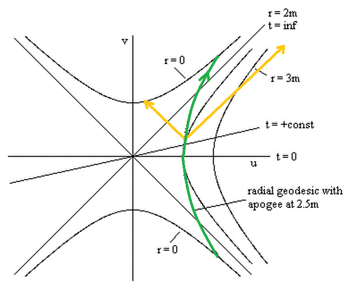

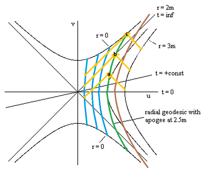

  • #41
Spin-Analyser said:
Hold on, let me just get this straight. You're both saying that light doesn't build up at the event horizon because it catches a lift from the matter that falls in behind it and move quicker than it would do otherwise preventing a flash of light when an object crosses an event horizon?
Neither of them are saying that there is no build up of light "because it catches a lift from the matter that falls in behind it". The infalling observer does not see an unusual flash of light at the event horizon, because he always sees light from the previously infalling observers, before, during and after passing the event horizon. Please see the first attached sketch titled "past" in Kruskal-Szekeres coordinates. The green curve is the path of the primary falling observer. The blue curves are the paths of previously infalling observers. The diagonal orange lines are light rays from the infalling observers. At event (a) outside the event horizon, the observer sees light from all 3 previously infalling observers. At event (b) the primary observer is at the event horizon and sees light from all 3 previously infalling observers that was emitted at the time they passed the event horizon. At event (c) the primary observer is inside the black hole and nearly at the singularity and he still sees light from all 3 previously infalling observers from when they were also inside the event horizon. Note that the primary observer never sees light from observers inside the event horizon, while he is outside the event horizon. Especially note that he never sees an unusual flash of light as he arrives at the event horizon. This is nothing to do with the light from previously infalling observers intersecting the light from other infalling observers. There still would be no unusual flash of light at the event horizon, if all previous infalling observers were transparent, or if they were slightly offset from the same radial path so that they are not hiding behind each other.
Spin-Analyser said:
.. when an object is falling towards a black hole the light from all previously falling observers is building up between them and the event horizon.
Not true. Again see the first attached drawing.
Spin-Analyser said:
.. Once the falling object is passed the event horizon any object further in is falling away from it faster than light so no light from previously falling objects can ever reach an object that has crossed the event horizon because the rate that objects in front of it accelerate away only increases once inside the event horizon, and no light from outside would be able to reach you because you'd be outaccelerating it, so it would be pitch black,
Also not true. In the attached diagram the observer at event (c) inside the event horizon still sees light from previously infalling observers, so it is not pitch black.
Spin-Analyser said:
or,
you can't overtake your own light and there is always an extended area where special relativity still applies. If this is the case then a falling object can see a previously falling object crossing the event horizon before reaching it themselves.
Also not true. The falling observer only sees previously infalling observers crossing the event horizon, when he himself is also crossing the event horizon. This is event (b) on the attached sketch.
The second attached sketch called "future" demonstrates that light (the diagonal orange lines) from the falling observer (green curved path) does not "pile up" at the event horizon. The inwardly directed light ray goes straight through the event horizon. You can also note that once light is emitted from the infalling observer, that the infalling observer never catches up with the light because his path never again intersects with the light paths.
Just for reference, the diagonal black line going from bottom left to top right labelled r=2m is the event horizon and the curve labelled r=0 near the top is the singularity of the black hole.

  • #42
I follow you up to (c). If a falling object is just a mm away from the event horizon then a falling object just inside the horizon is moving away faster than light relative to the more distant faller. That difference in relative velocity between objects depending on how close they are to the singularity only increases inside the horizon, so a falling object wouldn't be able to catch any previously falling light and no light from the outside could catch the falling object once inside the event horizon, so it would definitely be black.
Forget the light from previously falling objects. When approaching the event horizon the light emitted towards the black hole from the falling object moves away from them at the speed of light to start with, but slowing as it nears the event horizon. As the gap between the falling object and the event horizon decreases, the length of the valid frame of reference where light is moving away from the falling object at c decreases as well, creating an optic boom in the same way a planes own sound waves create a sonic boom.
If on the other hand there's always a valid frame of reference where light is moving away from the falling object at c then there must be a point close to the horizon where a falling object can tell whether or not previously falling objects have reached the event horizon yet.

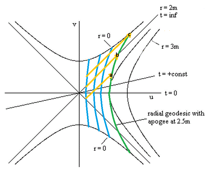

  • #46
Spin-Analyser said:
I follow you up to (c). If a falling object is just a mm away from the event horizon then a falling object just inside the horizon is moving away faster than light relative to the more distant faller. That difference in relative velocity between objects depending on how close they are to the singularity only increases inside the horizon, so a falling object wouldn't be able to catch any previously falling light ...
The Kruskal-Szekeres diagram I posted in my last reply clearly shows that the falling observer does catch light from previously falling objects whilst inside the event horizon so your statement here is not correct. Did you even look at the diagrams or just fail to understand them?
Spin-Analyser said:
... and no light from the outside could catch the falling object once inside the event horizon, so it would definitely be black.
I have attached an amended KS diagram "past2" that includes the light rays from an object that falls after the infalling observer and light rays from an object that remains outside the event horizon at r=3m. The infalling observer continues to receive light from both these objects (and previously infalling objects) outside and inside the event horizon. All objects that he can see while outside the event horizon are still visible when he is inside the event horizon. Your statement that "it would definitely be black" inside the event horizon is also not correct.
This "optic boom" effect you describe is clearly not present if you study the attached KS diagram. The KS chart is effectively the reference frame in which the infalling observer considers himself to be stationary. In this chart, the speed of light is always constant and not just locally so there is no slowing down of light near the vent horizon. In Schwarzschild coordinates, there is a sense in which the coordinate speed of light is slowing down but in the Schwarzschild chart, the infalling observer is also slowing down as he approaches the event horizon, so it is not clear that the falling observer is catching up with his own light. Everything near the event horizon appears to be "bunched up" near the event horizon in the Schwarzschild chart so that region is difficult to analyse in that chart. This apparent bunching up disappears in the KS chart that expands the event horizon region. This occurs partly because radial distances between events are measured to be much greater by the freefalling observer, relative to the measurements by the Schwarzschild observer in the region near the event horizon.
Spin-Analyser said:
If on the other hand there's always a valid frame of reference where light is moving away from the falling object at c ...
That would be the KS chart in the diagrams I have attached ...
Spin-Analyser said:
... then there must be a point close to the horizon where a falling object can tell whether or not previously falling objects have reached the event horizon yet.
... but again you have reached the wrong conclusion. There is no point outside the event horizon, where the falling observer sees light from events at or below the event horizon. Again, this should be very obvious from the KS diagrams I have attached.
If you interpret "moving away at c" as "moving along a 45 degree line", yes. But I would say that light "moves away from a falling object at c" only within the local inertial frame of the falling object, at the event where it emits the light. Beyond that you get into issues with trying to compare speeds at spatially distant locations in curved spacetime; the KS chart does not avoid those issues.
Definitely agree. Please note: I agree with the main substance of your post, since the key claims you are making about light rays and infalling observers are the same ones I've been making. But I think it's important not to confuse things by making statements about the KS chart that are either untrue or, at least, require interpretation that doesn't really help with the main topic of this thread.
I agree with the fine points you mention, but as you mention, they do not alter the main substance of the points I was trying to make. However, I was guilty of being a bit sloppy. Thanks for the correction!
I think the statements I made in the last post would be more accurate if we considered a non inertial observer in a rocket accelerating towards the black hole, in such a way that the worldine of the rocket is a vertical line in the KS chart.
Either way, the points about the ingoing observer:
1) still seeing light from objects outside the event horizon when inside the event horizon.
2) still seeing light from previously infalling objects when inside the event horizon.
3) not seeing light from events at or inside the event horizon, while outside the event horizon.
remain valid.
  • #49
That would be a "stationary observer" in the KS chart, yes. The acceleration profile would be a weird one. :wink:
remain valid.
Yes, definitely.
