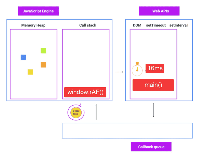

This figure from this blog helped me clear my concepts related to this.
Source: https://nainacodes.com/blog/understand-the-event-loop-in-javascript
1) Initially, window.rAF is passed to call stack.
2) By definition, rAF waits till next repaint of window which is 16ms for 60fps screen. It's like setTimeOut but better.

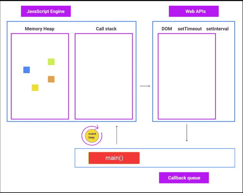

3) window.rAF() is executed, so it is removed from the call stack. Call stack is empty. Meanwhile at the same time, after 16ms has been passed, main() has been put into callback queue.

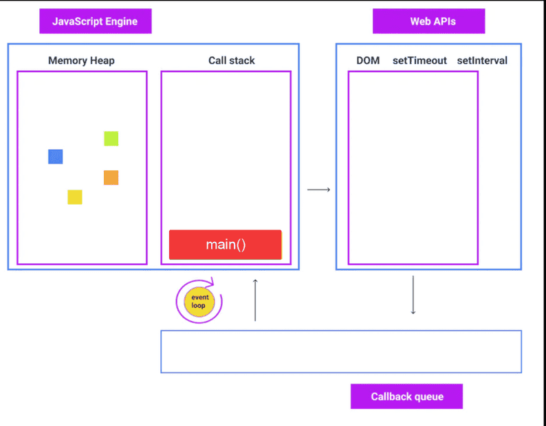

Now here is where the event loop comes in. The event loop is a continuous running process that constantly checks if the call stack is empty or not. If the call stack is empty, it will move the function from the callback queue into the call stack and it gets executed. So, main() gets executed.
4) Again, it calls window.rAF(main).

5) Now, the code under window.rAF() runs(the if condition and so on and so forth). After, 16ms, main() is passed to callback queue.
