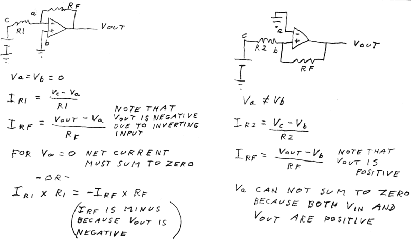

So, from my textbook, and what seems to be standard, an inverting amplifier circuit goes something like this:
However, when I switch the terminals of the op amp and follow through with the equations, I get the same Vout.
So my question then is what is the difference? I know there is other circuitry involved with the op amp internally, so I guess that's involved but I haven't gotten there yet.

When you flip the inputs you no longer have a negative feedback situation (where a portion of the output is fed back to the negative input of the op amp). The mechanism that forces ##v^+## equal to ##v^-## is no longer present. So indeed, the internal circuitry of the op amp is going to produce something different.
Think of the op amp as a dependent voltage source with some amplification factor A so that ##V_o = A(v^+ - v^-)## and reanalyze the circuit.
Likes sophiecentaur, Abdullah Almosalami and Dullard

Hmm. I think it's not quite a comparator circuit as the output does influence the input. It may be counter-intuitive at first glance, but the circuit will have a fixed gain and surprisingly, it turns out to be the same as for the negative feedback scenario.
My point was that you shouldn't rely on the "voltage rule of ideal op-amps" when setting out to analyze a scenario that doesn't clearly have negative feedback, and would be better served by going back to basics for a first pass at the circuit.
Likes Abdullah Almosalami and berkeman
The ideal op-amp assumption that Va = Vb is only valid if the amplifier is operating with negative feed back so that the high gain can adjust Va in the correct direction. If you remove the feedback, or change its polarity, you will create a comparator, not a linear amplifier, and the input voltages can vary greatly. So before you can apply the ideal amplifier approximations, you must verify that the circuit has the correct form of negative feedback.
You can do a more detailed (and accurate) analysis if you remove the Va = Vb assumption, and add in the amplifier gain Av as Vo = Av*(Vb-Va). Then observe what happens if you let Av get really large.

You seem to have gotten the signs a bit confused.

Turns out that this is not a good assumption in this case (that Vout is positive).
If we assume some gain ##A## for the op-amp, then since the (-) input is grounded then the (+) input must be at ##V_{out}/A##.
Write KCL for the (+) input node, see what you find. What happens when ##A## gets very large?

Some comments:
(1) The shown calculation in the first post (second case) contains no errors - however, one should stumble over the fact that the output goes negative although the non-inv. input is connected to the input signal.
(2) Even a simulation program (DC or AC simulation) will confirm the result.
(3) But we all know that - in reality - the result is wrong.
(4) Where is the error? The circuit with positive feedback would be a stable amplifier only in case the following (idealized) conditions would be met:
* No noise, neither internally nor externally.
* Absolutely stable supply voltages
* No power-switch-on transients.
(5) The mentioned calculation/simulations assume these unrealistic idealized conditions (like a large ball is riding upon another smaller ball).

Abdullah Almosalami said:
I could have gone wrong in the calculations, but I don't see it and no one has pointed out where,
Va = 0
and Vb = Vc + (Vout - Vc) X Ri/(Ri + Rf)
Vout = Avol X (Vb - 0)
Vout = Avol X (Vc + (Vout - Vc) X Ri/(Ri + Rf))
Gain = Vout/Vc = Avol X (1 + (Vout/Vc -1) X Ri/(Ri + Rf))
looks recursive to me. Check my algebra ?
old jim
Likes sophiecentaur
##\frac{Vout - Vb}{Rf} = \frac{Vb - Vc}{Ri}##
## Vb## and ##Vout## as in previous post
I was asking where did you get reasoning about the idealized conditions. As in, based on what more detailed model of the op amp that would now account for transients and noise and such. That's more what I was looking. I understand that switching the outputs doesn't work the same as seen from the equations shown so far, and it seems most of the replies are saying the mathematical model here is just ideal and doesn't work in reality, but to me that's a push to say alright then, well, what is a more accurate mathematical model? Perhaps more complex but something that could be used for analysis, and then maybe from that explore other cases.
No - the problem is not the need for a "more accurate model". The opamp models provided by the manufacturers are very complex and accurate enough.
The reason for the observed (surprising) results are the properties of the various analyses.
Ask yourself: What happens when a circuit with feedback tends to self-excitement ? The output voltage increases - and this increase is coupled back to the input supporting this increase ...We can observe that this process needs a certain (in many cases a very short) time due to unavoidable delays in real opamp models ...and, therefore, we can demonstrate this effect in a time domain simulation only (TRAN analysis).
In contrast, it is not the task of AC analyses to take into account such timely effects - these analyses must reveal the frequency-dependent properties of a circuit only and, hence, must assume steady-state conditions. For this reason, this analysis must assume that the supply voltages are switched on "long tiome ago". The same applies to the DC analysis , which - by its nature - cannot predict what the circuit perhaps will do in the near future because all delaying elements (like capacitors) do not contribute to the DC behaviour.
In summary - even in case of an unstable circuit, the simulation programm will always find a fixed DC operational point - and a following AC analysis shows a frequency response with gain. Remember, the AC analysis is a small-signal analysis - it is based only on the slope of a theoretical tangent applied in the DC operating point. These results are not surprising because our hand calculation would give exact the same results.
The only difference is that we - hopefully - will not start to perform such calculation by hand because we KNOW in advance that the circuit will be unstable.
Actually, previous posters have pointed out where you went wrong but perhaps they were too subtle for you and their message has been lost in the formulas. So, here's the fundamental point you have missed: what you labelled as the "Voltage Rule of Ideal Op-Amps", Va = Vb, in the first diagram in post #1 IS ONLY VALID FOR NEGATIVE FEEDBACK AMPLIFIERS.
The feedback in a negative feedback amplifier acts to drive Va (in your circuit) to be equal to Vb. In a positive feedback amplifier the feedback acts to drive Va away from Vb. Hence Va is not equal to Vb in a positive feedback amplifier. The Voltage Rule is not valid for a positive feedback amplifier and you cannot use it to analyse a positive feedback amplifier.
The problem with your analysis in the second part of post #1 and in post #13 is that you have still included your Voltage Rule; the assumption that Va = Vb, in your analysis . That is why your analysis gives you the results you know to be wrong.
To analyse the positive feedback rule you'll need to use the formula gneill gave you in post #2: Vout = A(V+ - V-).
Note that putting the wrong formulas into a simulation will produce the wrong outputs, even if it does look very neat.
EE textbooks (like the two I've looked at) derive the equations for the standard inverting input case but always ignore the other way around.
The standard equations are only valid for negative feedback circuits. There is no corresponding equation for a positive feedback amplifier because no corresponding positive feedback amplifier circuit exists. (You should however find an equation for a non-inverting negative feedback amplifier.)
Other posters have pointed out that an op-amp circuit with positive feedback gives you a comparator circuit with hysteresis, also known as a Schmitt trigger circuit. You may find an analysis of this circuit in your textbooks, or online.
What I was kind of hoping for was for someone to describe a more accurate model of an op amp that does account for all that was mentioned here.
You don't need a more accurate op amp model for this analysis. The introductory model is fine as long as you realize why your 'voltage rule of ideal op-amps' applies only to negative feedback circuits.
If you go back and re-read the thread, bearing in mind that your Voltage Rule is only valid for negative feedback amplifiers, you should find that the early posts do actually say this.

Example calculation:
Vin-Vp=I*R1; Vp-Vout=I*R2; Vp=Vout/Aol .
It is a simple task to solve this set of equations for Vout. Assuming Aol=1E5 and R1=1k, R2=10k we arrive at Vout=Vin*(-10.001).
Quite so as well.
But don't let a beginner think the circuit will perform a linear multiplication .
I too solved for Vout,, took limit as gain approaches infinity...
with infinite gain it's ## Vin X (1 - \frac {Rfb + Rin}{Rin} )##
so using your realistic R values and my infinite gain give ##Vout = Vin X(1 - \frac {11k}{1k}) = Vin X(- 10) ## , close 'nuff to your actual -10.001
set Vin = 0 and you get = ## 0 X (1 - \frac {11k}{1k}) = 0##
but don't let OP think the amplifier will be stable there.
The first accidental millivolt (of either polarity )that appears on Vout will be coupled, attenuated elevenfold, to the +input
which will drive Vout in the same direction , and a lot further because of gain
then get coupled back again to + input
causing runaway in that direction..
That's what positive feedback does.
The output will drive to the amplifier's capability and remain there.
So the circuit is not stable as algebra implies.
Nor is it astable as intuition implies
It's bistable, will sit happily at one limit or the other until you apply enough Vin to overwhelm the feedback and make it flip to the other state.
As has been mentioned already, it's the well known Schmitt Trigger and Rin / Rfb sets the hysteresis.
old jim
