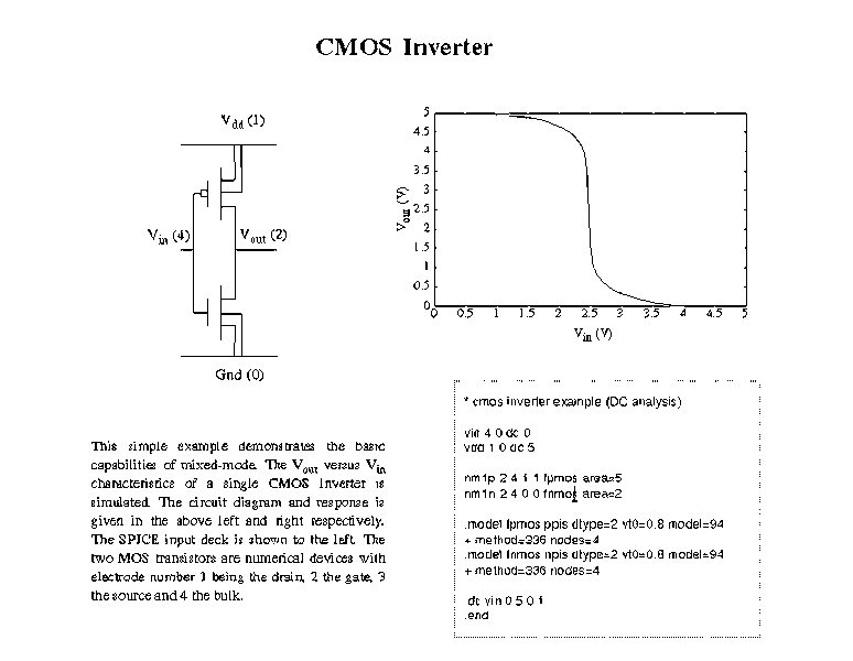

Thank you for your comprehensive explanation about the input and output impedances and what they are good for. I understand these components avoid some bad conditions that may occur. However, I still wonder how the invertion is done in a NOT gate in the second figure, or I don't know if the invertion should be understood from that image. Could you please explain that part also?
hitemup said:
@gneill
The equivalent model shows a controlled source that drives the output. It is specified that it produces the logical negation of what is "read" at the input. Note that the model does not include any details about how the input is read and interpreted, nor how that information transmitted to the controlled source. For that kind of detail you need to look at an actual implementation of a NOT gate, as @berkeman suggests.
berkeman said:
IMO it's better to just look at the equivalent circuit for a simple inverter, rather than try to understand it based on some abstract circuit model...
http://www-tcad.stanford.edu/~fmr/research/mixedmode/mmEGinvExample1.gif
many schools will teach "simple circuits" using just passive components and op-amps first. They don't touch transistors until later on in the curriculum. It is possible OP does not understand what a FET is.
