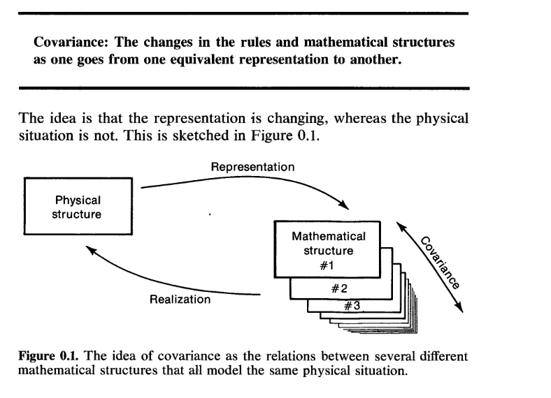

I like how William L Burke thought about covariance, so I'll post an excerpt from him
Likes Dale
