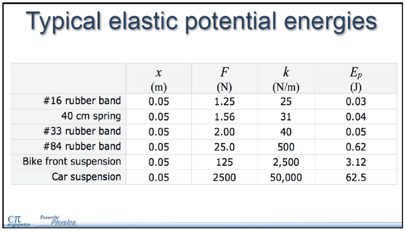

Well, according to this table from chapter 9.5 of Essential Physics (https://www.amazon.com/dp/1937827038/?tag=pfamazon01-20), a spring constant ##k## of ##20 \text{ N/m}## is roughly that of a small rubber band. So your steel spring is only useable with very light loads.
Likes DarkEnergy890
