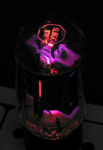

I have noticed that some of my tube amp power tubes are glowing slightly blueish. Why?
It has been explained to me that this only means that the tube is ok.
However, I find it fascinating!
Because what is this blueish glow, really?
To me it sounds like secondary emission of either the anode or the glass envelope.
It is either this or some residual gas that exists inside the tube.
But, with regard to what has been explained to me, I do not believe in this last part.
Do you physics experts perhaps have any explanation of this amazing phenomena?
Blue is normal but if you see this purplish/pink
it usually means a gas leak causing ionization instead of normal blue electron Fluorescence.

Interprating your first nicely provided link for interested people to read:
The blue glow I am thinking of seems to depend on the fact that not all the electrons in a vacuum tube actually strikes the plate. A few strays off and strike other things in the tube, such as the glass envelope and thus gives a faint blue just inside the glass envelope. Many types of glass will obviously give off a faint blue glow when bombarded by electrons of sufficient energy. I have seen for myself that the holes themselves gives patches to the glow.
Furthermore, it was interesting to learn that this somehow mainly concerns newly produced tubes. I am a witness of this because my RCA tubes do not glow like this while my friend's Sovtek tubes in exactly the same type of PA do.
This is very strange to me.
But thank you, this answers my question!
