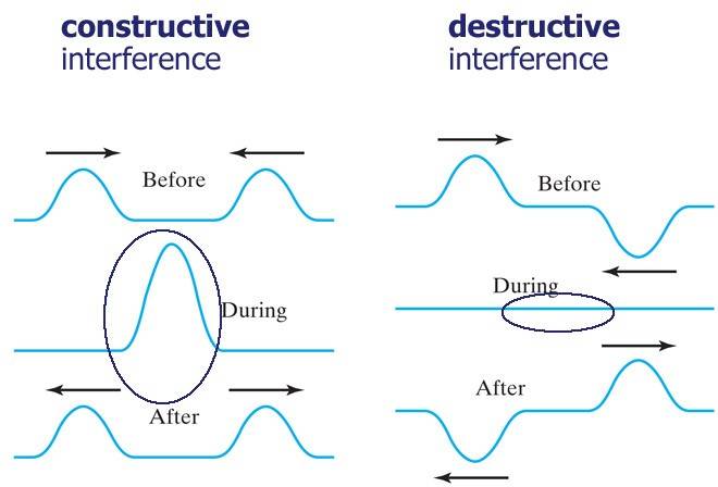

I don't really understand what your issue is. As the image of water waves in post #2 shows, the destructive interference forms lines of calm water with propagating waves between. What's the problem? Or are you concerned about waves propagating in opposite directions?
