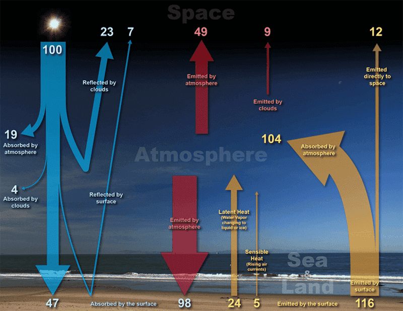

Look at the first picture in this article: https://www.weather.gov/jetstream/energy.
Solar radiation is the blue arrow labelled 100 at the top.
Global radiation consists of:
  • Direct (solar) radiation (the blue arrows labelled 47 (absorbed) at the bottom and 7 (reflected)) plus
  • Indirect (atmospheric) radiation (the red arrow labelled 98 at the bottom).
Ground radiation consists of:
it is global radiation...it is not ground radiation...are they same?
Yes sorry, that was a typo, I have edited it.
I am not sure what sources you are using to learn about this but I think the US government weather site I linked to is a good one.
