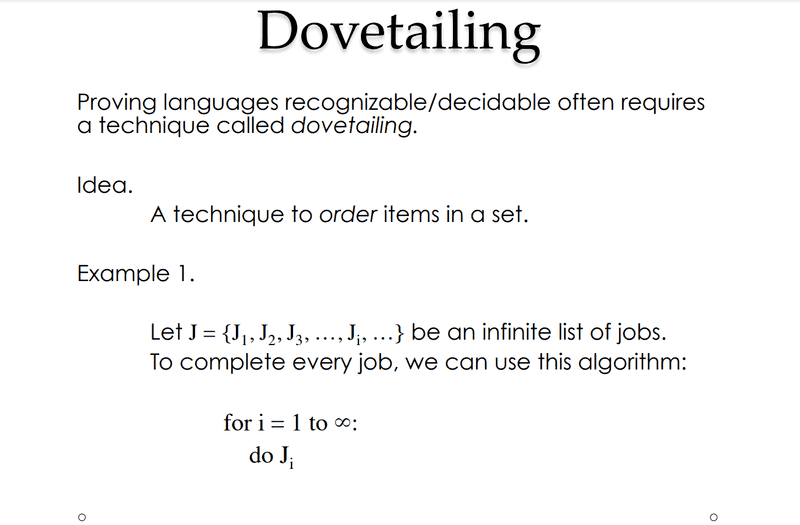

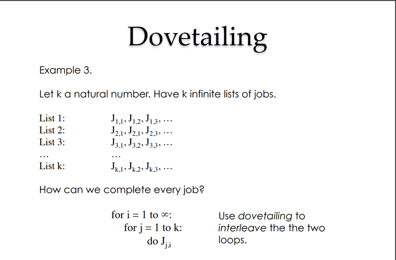

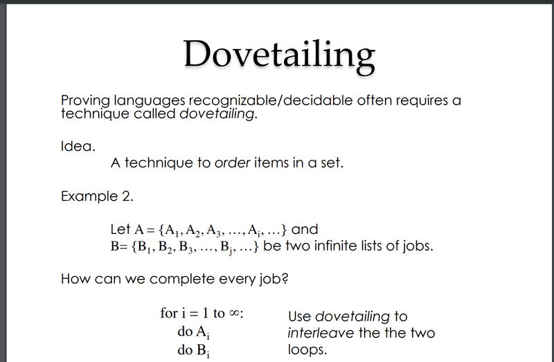

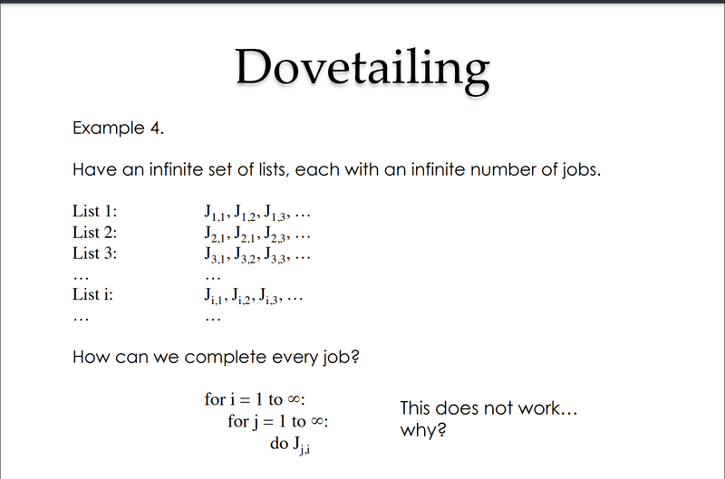

Explain dovetailing technique with suitable example
None
I have collected some information related to it. It seems like it is basically doing stuffs in parallel. But I am not 100% clear about what it really means.
Here is some information I've about it. But it doesn't really makes a lot of sense to me.
Source-: https://www.utsc.utoronto.ca/~bretscher/c63/lectures/w3_printable.pdf
can you help me figure this out? what is dovetailing? in simple words with an example?

It's just a way of interleaving (dovetailing) any number of infinite lists, ##J_{i,j}##, so that each list is done, even if there are an infinite number of lists.
I do not understand what the link in your second post is saying, but I think the first post is fairly clear.

. i am bit rusty with programming atm. can you explain what that last slide of my original post meant?
If you have an infinite number of infinite lists, you do not want to address all of the infinite number of lists at once. Instead, you only include a finite number on each iteration of the outer loop and do one more on the next iteration.

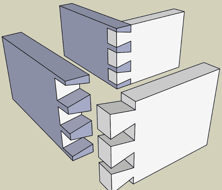

It helps to know that "dovetail" is a term used by woodworkers for a joint that connects two pieces of wood.
In the context of this thread, instead of different pieces of wood being interleaved, your study materials are describing tasks being interleaved.

Put simply, dovetailing is a method of working on multiple tasks at once. If you only have two tasks, this is easy:
$$ t_{0, 0}, t_{1, 0}, t_{0, 1}, t_{1, 1}, \dots $$
With ## n ## tasks it is still easy
$$ t_{0, 0}, t_{1, 0}, \dots, t_{n, 0}, t_{0, 1}, t_{1, 1}, \dots, t_{n, 1}, t_{0, 2} \dots $$
and that is all you need to know about dovetailing in practice.
Note that in theory you can handle an infinite number of tasks such that however large you make ## i ## and ## j ## you will always reach stage ## j ## of task ## i ## in finite time:
$$ t_{0, 0}, t_{1, 0}, t_{0, 1}, t_{2, 0}, t_{1, 1}, t_{0, 2}, t_{3, 0} \dots $$
