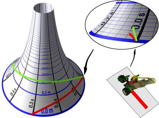

binis said:
Since space is curved within the Earth's gravitational field, every body that moves there will follow the curvature of space no matter what speed it has, so what will its trajectory be, how will it be straight, only if the launch is made absolutely vertically towards sea level? Only then can it escape? In that case, since gravity is not a force, no escape velocity is required?
You have to consider space-time, not just space.
On the diagram below the vertical axis is radial-space (black), while the circumferential axis is time (blue). The red & green lines are worldlines of two objects thrown vertically upwards at different speeds. Those worldlines of free falling object are geodesics (locally straight) in space-time, as modeled by the little car driving on the curved surface without steering. The green object has a higher initial upwards speed, and thus a larger initial angle to the time axis.
In this example both objects come down. But it's easy to see that if you increase the angle (intial upwards speed) even more, the car will never return the blue baseline, just keep spiraling up along that funnel, and escape to infinity.
From: https://www.relativitet.se/spacetime1.html
Likes binis, ersmith and Sagittarius A-Star
