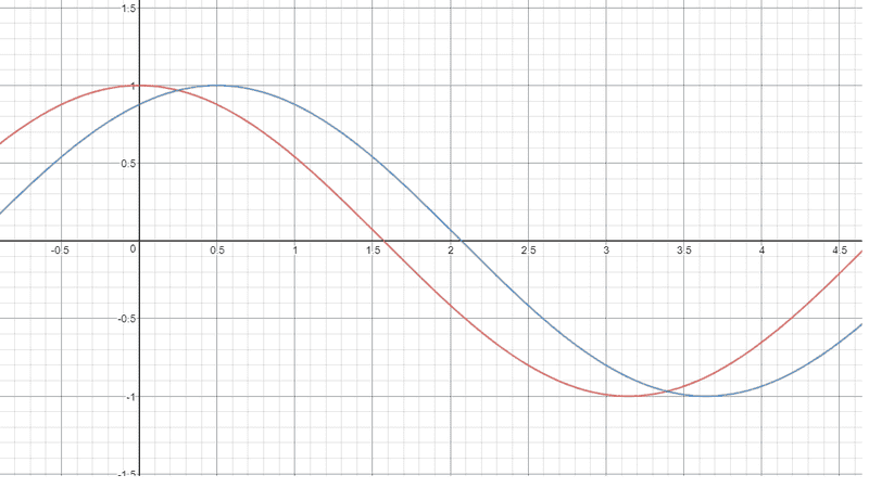

Like this graph right? At x=0.25 they are both opposing in motion, then they both descend together, and then oppose again
No. At x=0.25, they are both positive and add together. They oppose in 1.6 < x < 2.0, where one is positive and the other is negative. In general, they add together instead of opposing. They could better synchronized, but not by much.

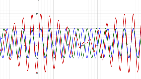

In the diagram below, the blue and green lines are two different frequencies and the red line is their sum. The red line shows that the blue and green reinforce each other at x=0 and phase drift so that they almost cancel each other at x=30.
