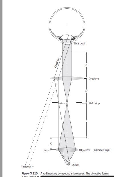

Ok so if an object is placed at the focal point of a convex lens, it will have it's rays collimated -- which I assumed to mean that all rays would end up parallel to each other.
But then, I saw this diagram of a simple compound microscope from Hecht "Optics" 5th ed:

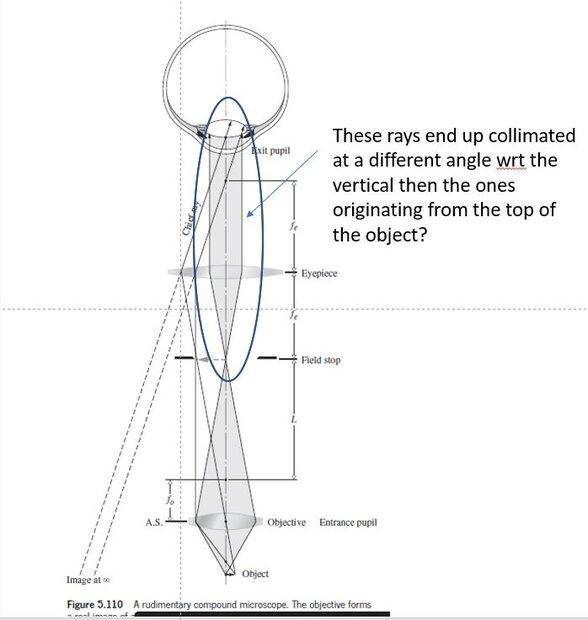

And I noticed that all the various rays emerging (I think they do that because of Huygen's principle?) from the bottom of the image at the field stop (the one I've circled in the diagram above, it's effectively an object for the eyepiece) end up collimated with an angle of 0 degrees with respect to the vertical. However, the various rays emerging from the top of that same image are also collimated but they are at an angle (maybe 30 to 40 degrees eyeballing it) with respect to the vertical. So that means when rays of an object are collimated, not all of them end up parallel to each other? Only the ones that are "Huygen's diverging" from the same point on the object end up parallel to each other? I had interpreted it that collimation would mean all rays from all across the object would be parallel to each other but I'm pretty sure that's not right and I'm not sure if my new understanding is right either.
That is certainly not true. Look at the ray labelled "chief ray" on the diagram. I do not know Hecht but have heard less than glowing comments...that diagram is terrible IMHO. Unfortunately I do not know a really good text.( I never actually took an "optics" course although I have designed a lot of optics. ) The purpose of any focusing optic is to provide a one to one map of the image plane to he object plane and vice-versa (subject to certain constraints)
Okay. I see that the chief ray, originating from the top of the original object passes through the top of the circled image. Then it refracts through the eyepiece and corresponds to an infinite image with its rays at a slight angle wrt the vertical. At the same time, it really looks like to me that the rays from the bottom of the image at the field stop (the ones I've circled below) end up aligned wrt the vertical. How do we make sense out of this?
Ah okay. What exactly is generated then? Is a finite sized object some sort of a superposition of point sources ... so that if you place such an object at the focal plane of a lens you get a ton of different plane waves from each point source that makes up the object?
Basically, yes- that is the idea behind "angular spectrum" analysis of optical systems. There is a wrinkle, tho- the result varies depending on the spatial coherence of the extended source. That is to say, the total optical field will depend on whether the individual plane wave components of the optical field are mutually coherent, mutually incoherent, or partially coherent.
