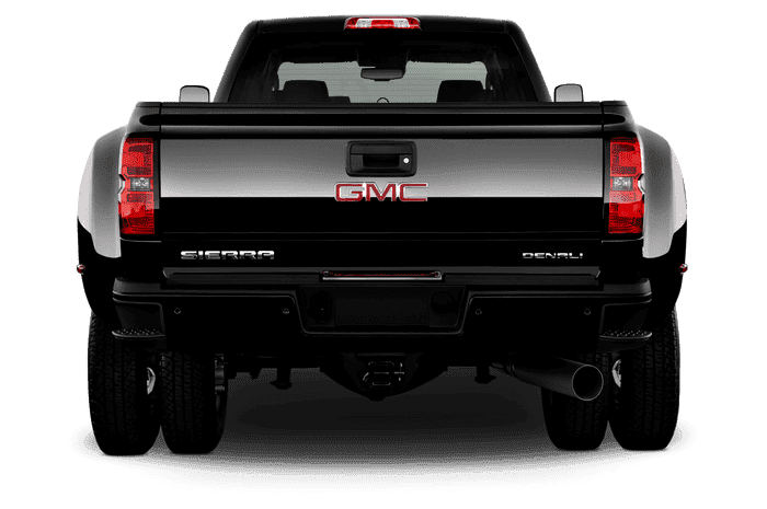

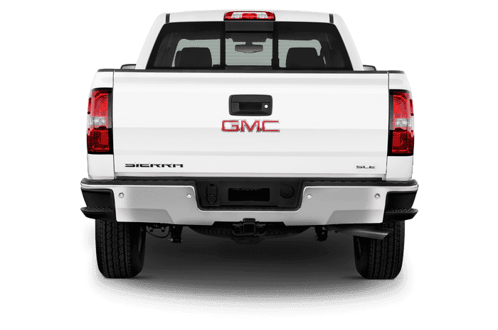

What is the advantage of having a dually truck vs. nondually?

Bottom line is The advantage of a DRW is the stability while towing. Disadvantages include the rear of the truck being nearly 8ft wide and the 2 extra tires to purchase every time you need new tires. They also do a little worse on fuel because of the extra tires. It a bit better towing by 2 MPG but empty you will lose about 2 mpg.

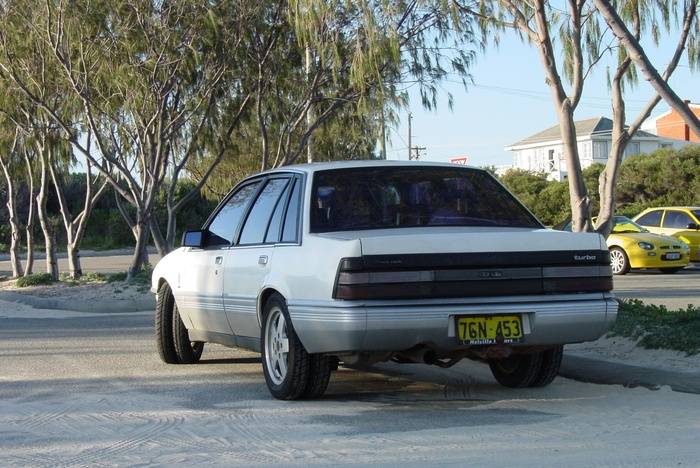

«Twin-tires» for cars were introduced on the market in the 80's, but they never caught on despite better performance. They supposedly run 20%-30% cooler and reduce hydroplaning by 80%. The only draw back seem to be a diminution in confort.
Still some info the net:
A good idea at the time: Twin tyres
Drivers Do a Double Take as Two-Tire-Wheels Roll In : Roadability and Safety Stressed
TWIN TIRES—- THEY'RE BACK: NEW FIRM TO MARKET SYSTEM IN U.S.

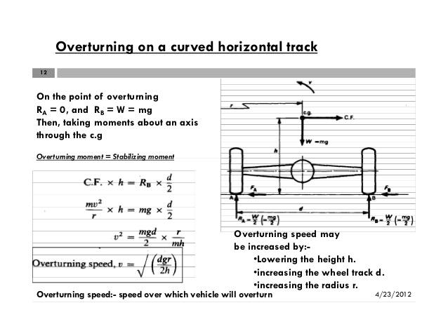

Overturning will occur at the same point since it is the hardness of the suspension that decides the lean and the movement of the centre of mass.
Actually the main characteristics for overturning is the height of the center of gravity and the track width as shown in the figure below. Though, a softer suspension will generally lower the maximum lateral acceleration before overturning occurs.
In the US vehicles are limited to 8 feet wide in some states and 8.5 feet wide in others. Cab and chassis models of domestic trucks have the same axle width as a single wheel truck, however they use a reversed wheel on the inside dual with another reversed wheel opposite on the outside dual. A single wheel version tracks almost center of midpoint of the dual wheels on these models. Often a cab and chassis model will be fitted with a flat bed body. On a dually pick-up truck which has a factory pick up bed with dually fenders adapted to the outside quarter panels, the width of the bed between the fender wells remains at 4 feet, the same as a single wheel model of the same truck. The axle housing is wider spacing the wheels further apart, and the inside dual rides the same distance from the frame and the inside wheel well maintaining a 4 foot clearance between the wheel wells exactly like a single wheel model. The minimum 4 feet width between the inner fenders is a standard for US built pick-ups. The standard size for plywood is 4 x 8. Slide-in campers have a 4 foot width at the base where they sit in the bed. 5th wheel hitches are built to place between 4 foot width fenders. A standard shipping pallet is approx 4 feet wide. The outside duals widen the trucks width by the width of the tire and wheel, making the entire width of the truck at nearly 8 feet compared to a width of close to 7 feet on a single wheel version of the same truck. I am using the terms close to because different models vary somewhat within a range. The width of the outside duals matches the width of most cargo trailers, many trailer-able boats, and RV's. The inside dual tracks the same as the front wheels. Springs are mounted in the same location, however dual wheel trucks have a higher GVW compared to single wheel counter-parts and have HD springs which limit body roll. Add to that most dual wheel pick-ups are equipped for RV use and a torsional sway bar is included. Increased spring tension and sway bars reduce body roll. The increased width of the wheel tracking effectively lowers the center of gravity for the overall load.
Softer suspension effectively narrows the track width. The effect is most pronounced with loads that have a high centre of mass.
The term “Truck” needs to be better defined, or more carefully used.
There is no question that widening the vehicle track will increase stability. That may be possible with pick-up trucks as they are not normally 8 feet wide, but it is not possible with semi-trailers used in the trucking business as they are already 8 feet, (or 2.5 metre wide).
Widening the track while maintaining the same wheel base reduces directional stability during acceleration and braking if ABS is not fitted. That may lead to overturning if directional stability is not maintained.
