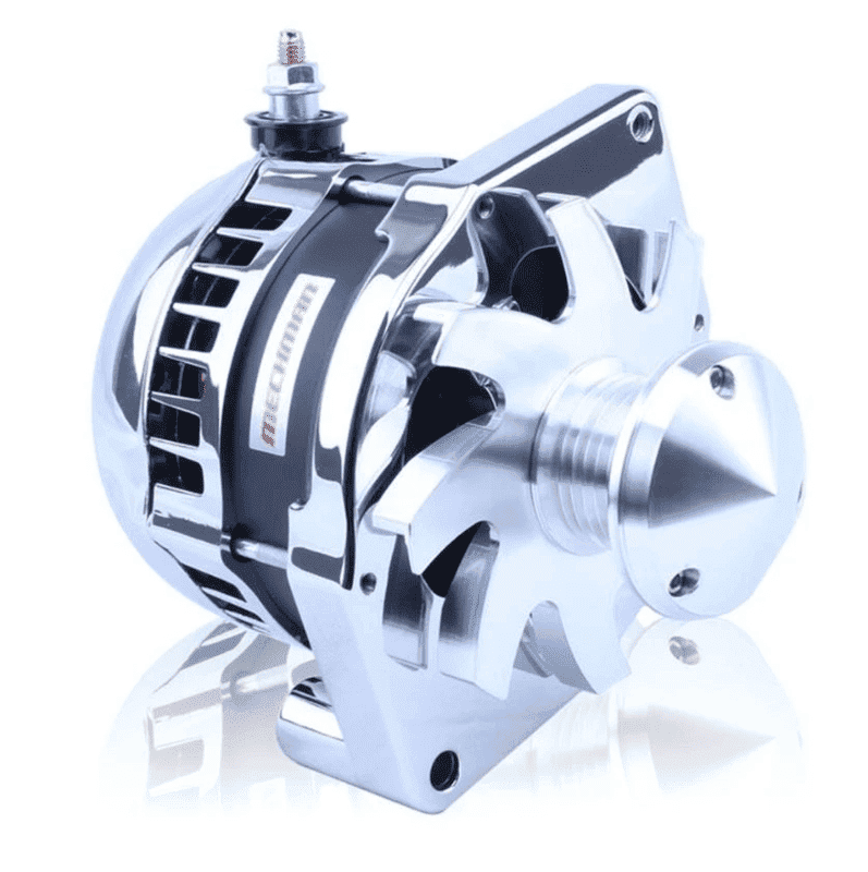

Captain Mike said:
however the best option for my needs would be to have two separate electrical systems.
Simplicity is usually a good thing.
Separate systems eliminates need for interfacing them
but the physical task of mounting a second alternator is daunting to those of us without access to a machine shop.
Fortunately the audio guys with their preposterous subwoofer amplifiers have created a market for such a thing.
try a search on "dual alternator bracket"
Likes Joe591 and dlgoff

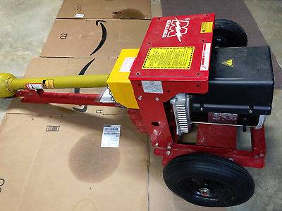

A 10kw continuous duty inverter won't be a super cheap item. Only one I could google was US $3000.
I'm wondering if there are alternators for catering vans that produce 220V directly. No battery or inverter required. There would need to be some sort of throttle control.
Think this route is a job for a specialist conversion company.
CWatters said:
I think it would need to be at least a 48V system.
That works too. https://www.ebay.com/itm/WinPower-PTO-Powered-Generator-10kw/163439582159?hash=item260dc21bcf:g:MwkAAOSwOcpcGbFs is one that works from a power take off. About $1500. I presume it is an induction generator. For 10 kW, PTO sounds more practical than belt driven.

I still think the power-take-off generator sounds best. See #13.
It is located outside the vehicle; thus fire safety. (Alternators under the hood can start their own fire.) There is no external engine, so no audible noise to bother customers. It is AC, no inverter needed. It is disconnected while driving. It beats multiple alternators on simplicity.
Are there kits to add a PTO to a truck engine?

A PTO like what @anorlunda suggests is a good way to go using a truck engine as power source. I'm having a hard time envisioning fitting the required number of off-the-shelf alternators under the hood, and belting them to the engine shaft. If not a truck engine-driven PTO then an externally driven genset may be the best option.

It all depends on your needs. A quick search shows that the largest alternator for a truck is 320 A @ 12 V. That is 3840 W (= 12 X 320) of power. Is that enough power for your needs? You still need some electrical system to convert that current to something useful. I doubt you are using equipment working with 12 V direct current, which is the alternator output. If so, great, you only need to change the current truck alternator to a bigger one!
I wondering if that 12V 320AMP alternator you've mentioned, suitable for any truck, how do I find out that I can use some model with my truck?
  • #32
It's a bit expensive (~$725 USD) -- I'm thinking about buying one for my 1985 4.8L inline-6 Chevy P30 Step-Van -- look up '6-phase versus 3-phase' if you're interested -- you might need a different regulator, too -- as others have pointed out, it may not be the best way to generate electricity -- I have a 3.5 kw gasoline-powered generator with a Honda engine (less loud than some others), but I think it's probably a good way to do it if you're going to use your truck's engine to do the side job of providing electricity -- https://www.droppinhzcaraudio.com/p...f-exciting-chrome-w-march-1-75-pulley-and-fan
Likes jack action
  • #33
That's an impressive alternator. You will also need a special 6 groove serpentine belt and a new crankshaft pulley to match. The description says that it is designed to work at 800 RPM idle speed.
I'm not a M.E., but I would guess that this must stretch the limits of pulley-belt power transmission with its small diameter, low RPM, and high power.
Likes sysprog
  • #34
Yeah -- there's a lot that goes along with it -- but that engine can produce enough power -- you make some adjustments, and it'll work -- I'm looking at a 2-alternator option set as well . . .
