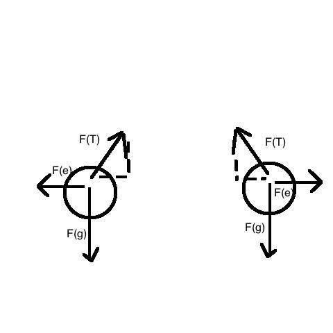

Two small pith balls, each of mass m = 12 g, are suspended by 1.2 m fine (so that we can neglect their mass in this problem) strings and are not moving. If the angle that each string makes with the vertical is θ = 42.6°, and the charges on the two balls are equal, what is that charge (in μC)?
F(T)+F(g)+F(E)=0
F(Ty)=F(g)=mg
F(Tx)=k(q^2/r^2)
I really don't know how to manipulate these formulas to find an answer. I know you find F(Ty) first, but then I don't know how to get F(Tx). I think I am missing a formula somewhere. Please Help Thank you
You're pretty close, but the problem has an additional piece of information that you haven't used yet. Hint: it's the angle!
Probably best to draw free-body diagrams first perhaps?
Hi Dancer, welcome to PF.
The force diagram is attached
F(Ty)=cos(θ)*F(T) - - - F(T)=F(Ty)/cos(θ)
F(Tx)=sin(θ)*F(T) - - - F(T)=F(Tx)/sin(θ)
So, F(Ty)/cos(θ)=F(Tx)/sin(θ) - - - F(Tx)=[F(Ty)*sin(θ)]/cos(θ) - - - F(Tx)=F(Ty)*tan(θ)
Did I do all of that correctly?
Sorry here is the force diagram actually

The next step after drawing the diagram is to add up the forces in each direction. Start with just the left-hand ball. eg. [tex]F_T\cos\theta=F_g[/tex]... do the horizontal one, then write out what each of the forces actually are. eg. [tex]F_e=\frac{kq^2}{r^2}[/tex]... and r is related to the angle... see?

Yeah, that's right. tanØ=Tx/Ty
So you're set, work out the algebra from here. Don't forget, as Simon mentioned, to get the EM force in terms of "x distance."
F(Tx)=mg*tan(θ)
q=√((F(Tx)*r^2)/k)
would r be mg/tan(θ)??

Nah, that would be the horizontal force, which is the coulomb force you're in part trying to solve for. You've a string length you haven't used yet. ;)
Ok so sin(θ)*string length=r
SO..
F(Ty)=F(g)=mg
F(Tx)=k(q^2/r^2)
F(Tx)=F(Ty)*tan(θ)
q=√((F(Tx)*r^2)/k)
F(Tx)=mg*tan(θ) - - - - - - - - - F(Tx)=.012kg*9.81m/s^2=.11772N→A
q=√((F(Tx)*(sin(θ)*L)^2)/k)----q=√(A*(sin(42.6)*1.2)^2/9E9)=2.938E-6C or 2.9μC
Is 2.9 μC the correct answer or did I make a mistake?
Careful, you want the total distance between the pith balls. You just found one half, one leg.
