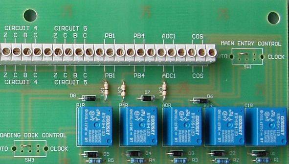

What will be the color code of a zero Ohm resistance?
Not really such a daft idea, actually. The zero ohm link could be replaced by a link, when required, with finite resistance which would fit straight into position.Nidum said:If you ask enough silly questions you will just sometimes get a sensible answer :
https://en.wikipedia.org/wiki/Zero-ohm_link
Yup, very common in industry practice. One incorporates a number of "jumpers" into the circuit design. Removing or adding zero-ohm resistors at those points selects certain circuit behavior - for instance, choice of 5V or 3.3V power.sophiecentaur said:Not really such a daft idea, actually. The zero ohm link could be replaced by a link, when required, with finite resistance which would fit straight into position.
Clever. So this way the PC board doesn't have to be modified, just the component insertion process. When I was an engineer trainee back in the '60s we just used wire jumpers, but then we were doing everything by hand but this is great for automation. I DO recall that the wire jumpers we used (they weren't just wire, they were a plastic form containing pins) were smaller than a resistor form factor and I remember using the same things on PC boards back in the early days of personal computers, but they didn't allow the option of putting an actual component in the same position which, as Sophie points out, these do.tfr000 said:Yup, very common in industry practice. One incorporates a number of "jumpers" into the circuit design. Removing or adding zero-ohm resistors at those points selects certain circuit behavior - for instance, choice of 5V or 3.3V power.
I use lots of these in commercial gear I buildNidum said:If you ask enough silly questions you will just sometimes get a sensible answer :
https://en.wikipedia.org/wiki/Electronic_color_code#Resistor_color-codingshahroz said:What will be the color code of a zero Ohm resistance?
