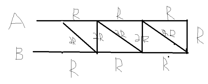

What is the combined resistance here?

What is the combined resistance in this circle between A and B.
Honestly I have no idea what to here, any explanation will be great.

Have you studied series-parallel reductions?
Start from the extreme right. What can you say about the two Rs in the rightmost loop?
This is the only thing I knew how to do here. They both combine to one resistor with a resistance of 2R.
Right. Then what happens to the two 2Rs? How are they connected?
Their connection is parallel.
Yes. So now you can go on simplifying the network until you find the equivalent resistance.

Alright, thank you! I think I got it.
