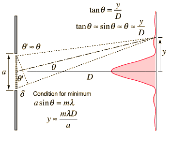

SINGLE SLIT DIFFRACTION
In order to find the minima the following formula is used, a*sinθ=n*λ, what does "n" exactly mean and how does the order relate to the dark/bright spots on the screen, (a=slit width,λ=wavelength).
The extra distance traveled by the rays = a/2*sinθ, while the phase difference is always λ/2 (learned via youtube video above)
So, a/2*sinθ=λ/2 from which we find the formula a*sinθ=n*λ
Sinθ can be replaced by x/D, where x is the distance from the central max to the desired Max/Min and "D" is the distance from the screen to the slit.
1st Dark Spot on the screen: a/2*x/D=λ/2, what does "n" equal here, is it 1? and does a*sinθ=n*λ apply?
1st Max Spot: a/3*x/D=λ/2 (found from video), what does "n" equal here and does a*sinθ=n*λ also apply here.
How will i know in a question if i need to find a Max or a Min? As i can't seem to find the relationship between the order and the dark/bright spots on the screen.

Hi there!
For future reference, I recommend you to numerate and group together your questions which will them easier to answer. This, I would say from personal experience, boost the probability for your inquiry to get an answer.
Nevertheless, let "path length difference between interfering waves" = ψ, and you write
Are the following correct:
Central Max: n=0
1st Dark: n=1
1st Max: n=2
2nd Dark: n=3
which corresponds to
ψ = n/2 * λ; n = 0 - constructive interference
ψ = n/2 * λ; n = 1 - destructive interference
ψ = n/2 * λ; n = 2 - constructive interference
ψ = n/2 * λ; n = 3 - destructive interference
... is correct. If I understand your question correct, you want to know the physical interpretation of n? Diffraction patterns are mostly about (constructive and destructive) interference. Furthermore, constructive interference gives maxima and destructive gives minima in the diffraction pattern.
Now, let two light waves of same frequency/wavelength start from the same point in space, meaning the single slit, but not necessarily at the same time. Then they meet up to interfere at some other space point for example the screen showing the diffraction pattern, at the same time, where they interfere. The two waves will interfere depending on the different path lengths they have traveled (as you have written) and here is where the n comes in:
(1) If the difference in path length is exactly zero, they interfere constructively giving a maxim
(2) If the difference in path length is exactly ONE wavelength, they interfere constructively giving a maxim
(3) If the difference in path length is exactly TWO wavelengths, they interfere constructively giving a maxim
Or in general, if the difference in path length is exactly , where n=0,1,2..., they interfere constructively giving a maxim, of order n. Hence, in this example, n gives the number of wavelengths one wave have traveled longer than the other as they meet to interfere.
Then what happens if we turn it around? Say, one wave traveled /2 longer than the other. This implies destructive interference, because now one wave's top meets the other's bottom.

I have a better understanding of constructive and destructive interference thanks to your post, just have some confusion with the math and formulas.
ψ = n/2 * λ; n = 0 - constructive interference, so this is the Central Max
ψ = n/2 * λ; n = 1 - destructive interference, 1st Dark
ψ = n/2 * λ; n = 2 - constructive interference, 1st Max
ψ = n/2 * λ; n = 3 - destructive interference, 2nd Dark
From the video link in the OP, to find the 1st Max (Bright spot/constructive interference) on the screen:
a/3*sinθ=λ/2, which gives x=3λD/a2. Is that correct? I was trying to find it by what you had said for constructive interference, " difference in path length is exactly nλ, where n=0,1,2..., they interfere constructively giving a maxim"
So this is what i was doing, a/3*sinθ=nλ where n=2 due to the 1st Max but was unable to get x=3λD/a2 which is the correct answer for finding the 1st Max on the screen
And also for the 1st Dark, we have a/2*x/D=λ/2 which becomes x=Dλ/a
For this 1st dark spot(destructive), i done the following:
a/2*sinθ= nλ/2 where n=1 due to the 1st Dark spot but was unable to get x=Dλ/a
I want to be able to find the position of the required Max/Min from the central max on the screen but don't know which formula to apply
Also for constructive interference you said that the difference in path length was nλ but also said the path difference is ψ = n/2 * λ for constructive interference when n=0 and n=2, shouldn't ψ = n/2 * λ just be for destructive interference where:
to find a minimum its: a/2*sinθ= nλ/2
to find a maximum its: a/2*sinθ= nλ

I have cut down my previous post and wish to know the answers to the following questions regarding the formula in finding the bright/dark spots for single and double slit diffraction please
(a=slit width,λ=wavelength, D=Distance from screen, x=distance of max/min from central max and n=order)
SINGLE SLIT
In order to find the min is the following formula used, a/2*x/D=n*λ/2
and to find the max the following is used, a/2*x/D=n*λ (i think this one might be wrong?)
where n= 0.,1,2,3 or 4 etc
are the above formulas correct?

Hi again!
I'm sorry I haven't been able to answer before now as I've been struggling with a project of my own. Anyways, let's see..
First, this MIT-paper answers all your questions in a really good way. I highly recommend you just read from the start of chapter 14.4 (it is not very long!)
MIT-paper: http://web.mit.edu/viz/EM/visualizations/coursenotes/modules/guide14.pdf
THE SINGLE SLIT
It's a little difficult to say your formula is wrong as I do not know where you got it from. Nevertheless, look at the picture given from this HyperPhysics site: http://hyperphysics.phy-astr.gsu.edu/hbase/phyopt/sinslit.html, as seen here:
Then study each of the three rays. With "Fraunhofer diffraction", we mean that the distance (D) between the slit and the diffraction patter (screen) is so large that the angle between each ray and the D-line is essentially equal, namely [itex]\theta [/itex].
That is, by convention: [itex]\theta [/itex] is the angle between mid-ray and D-line. The Angle between top ray and D-line is [itex]\theta - \Delta_1[/itex] and angle between bottom ray and D-line is [itex]\theta + \Delta_2[/itex] from some angles Δ, and as D becomes laaaaarge (Fraunhofer diffraction): [itex]\Delta_1 = \Delta_2 \approx 0[/itex].
Using the picture: Now, we study only the two rays, bottom and top, and only use the middle as reference. Convince yourself that the bottom rays travels δ longer than the top ray! You see that δ changes with [itex]\theta [/itex]? For example is δ zero for [itex]\theta =0[/itex], giving diffraction max of order zero (constructive interference).
The whole point from here is to find the relation between δ and the y-coordinate on the screen, given by [itex]\theta [/itex]. We do know, that diffraction max(!) occurs for [itex]\delta = n\lambda [/itex], [itex]n=0,1,2,... [/itex]. But by trigonometry (see the picture), you see that,
[itex]
sin(\theta ')= \frac{ \delta }{ a }, \theta ' \approx \theta
[/itex]
as D is large. Here δ is (still) the path length difference between top and bottom ray.
And here comes the hard part, where I personally thinks the picture fails. Until now we have studied the path length difference between top and bottom! For interference, we actually want light from the end of the slit to have traveled [itex]\delta = n\lambda [/itex] longer than the middle, reference ray! Not the bottom ray! Think about it before you continue to read. This is not trivial: ask your lecturer/teacher, and read the MIT-paper.
When we accept this, we may write instead (a → a/2), and use different order for max and min:
[itex]
\sin(\theta)= \frac{ \delta }{ a/2 }
[/itex]
Here δ is now the path length difference between top and middle rays! Furthermore we write
[1] Constructive interference (diffraction max) for [itex]\delta = n\lambda [/itex]
[itex]
a \sin(\theta)= 2 n \lambda, \quad n=0,1,2,3,...
[/itex]
[2] Destructive interference (diffraction min) for [itex]\delta = \frac{m}{2}\lambda [/itex]
[itex]
a \sin(\theta)= m \lambda, \quad m=1,2,3,...
[/itex]
Now is the time to relate [itex]\theta[/itex] to the screen. In the picture, they use y-coordinates so I'll do the same, with origin as indicated in the picture (where D-line cross y-axis). Then with [itex]\theta[/itex] as the angle between reference ray (mid ray) and D-line, then y-coord. is given by,
[itex]
\tan (\theta) = \frac{y}{D}
[/itex]
Now, since D is very large we say that [itex]D >> y[/itex] meaning [itex]\theta[/itex] becomes small, which means we can write [itex]\tan(\theta) \approx \sin(\theta) \approx \theta[/itex], which makes us able to connect with the other equation yielding (for destructive interference),
[itex]
a \frac{y}{D}= m \lambda
[/itex]
and finally,
[itex]
y = \frac{m \lambda D}{a}
[/itex]
For destructive interference (diffraction min)
and
[itex]
y = \frac{2n \lambda D}{a}
[/itex]
For constructive interference (diffraction max)
Where only n may be zero..
which are identical to what you write (x → y)??
Now I use quite some time answering as I cross check my sources to give solid answers, and this is what I managed right now. I'll come back for more as soon as I got the time, but in the meantime look at this. For multiple slits, it isn't really much different than for a single: you might figure it out without more help, but I or someone else will be back.
Good luck!

Thanks a million! I have a better idea in-regards to find the Max/Min. Just have some questions if you don't mind.
I can see that the condition to find the minimum can be generalized to the following formula:
a*sin(θ)=mλ, m=1,2,3
where to find the 2nd min spot m=2 and then when we use "a*sin(θ)=mλ" we get y=2λD/a which is correct.
However to find the first max we use the following formula which you have designated, a*sin(θ)=2nλ. And say i need to find the 1st Max, would n=1? as its the first Max. Then Since n=1, y=2λD/a but this is wrong i think?
In the video, to find the 1st Max we have the following: a/3*sin(θ)=λ/2 where y=3λD/2a how can i apply a*sin(θ)=2nλ in this case to find the 1st Max?
Also for Double slit interference i worked out that to find the Max the a*sin(θ)=mλ, m=1,2,3 formula can be applied, but which formula can be used to find the minimum?
Thanks again for any help
Hi again! How are you doing, figured it out yet?
Reading my own answers made me realize I could have formulated myself much better. Besides, I have made a rather crucial mistake which you actually point out! Creds to you!:)
You write that we can se from the condition to find the minimun can be generalized to the following formula:
[itex]a \sin (\theta) = m \lambda, \quad m = 1,2,3 [/itex]
(I'll call this the destructive interference eq. [DIE])
which seems be correct, and then you quote me who find the maximum bu coming up with some answer which you believe is incorrect, and here you're right as well. I did the math making some pretty bad assumptions, but won't take this further here now.
The thing is, and I quote wikipedia, which after finding our (correct) expression for the minima, says: "There is no such simple argument to enable us to find the maxima of the diffraction pattern.". And why is that actually?
One way to think is that you are solving an equation describing the intensity (of light or E-field if you'd like) of the diffraction pattern. Solving this single equation for finding the minimum is obviously done by finding y (i.e. the screen coordinate) which gives zero intensity (i.e. one side of the eq. is zero). Finding the max is not possible this way as we have no idea what the intensity actually is at the max: is it 1, 10, 143652? You get my point..
So, how do we find the max? You'll have to assume Fraunhofer diffraction and do some magical math which makes you able to show that,
[itex]
I (\theta) = I_0 sinc^2 \left( \frac{a \pi}{\lambda} \sin(\theta) \right)
[/itex]
(and I'll denote this the intensity eq. [IE])
This is the "intensity-function" with respect to Θ (which may be translated to y-coord.), and is easily deduced for it's maxs and mins. Here you could for instance check if the mins of DIE correponds with IE, concerning coordinates Θ or y.
I haven't derived this [IE] for quite some time, but I may look it up and show you if you haven't figured this all out by now.
A side comment to my earlier answer concerning the reference line from the picture from HyperPhysics
I wrote that you need to find the difference in path length for the top and middle ray: this is rather inconsistent and confusing (at least i think so). Fact is, that the middle ref. line/ray is just a mean of the two ends. In reality, we should not only look at waves emitted from the ends of the slit but from all of it! Let's look into it,
The Physics (or rather Huygens' Principle) state that any point on a wave wront may be treated as a new single point source emitting new waves. What does it mean? Look at this picture,
http://upload.wikimedia.org/wikipedia/commons/6/60/Refraction_on_an_aperture_-_Huygens-Fresnel_principle.svg
As the (assumed plain) wave enters the slit to be diffracted, we may discretize the wave's front as a set of new point sources, all emitting new waves. Such point sources are indicated as yellow dots in the picture. Of course, in reality, any point is a new point source, meaning the yellow dots are actually continuous along the slit opening. However, it illustrates my point, that each of these yellow dots emits waves, which will interfere constructively or destructively creating a diffraction pattern depening on each yellow dot's distance to the point on the screen.

Thanks, that makes thing much clearer in my mind now. I had researched a bit too and found that there was no way to find the max that way while it was easier to find the minimum via the designated formula.
I managed to find the 1st Max via the following formula:
sin(θ) = (2m + 1)* λ / 2a where m= 1,2.
Cheers for all the help!
