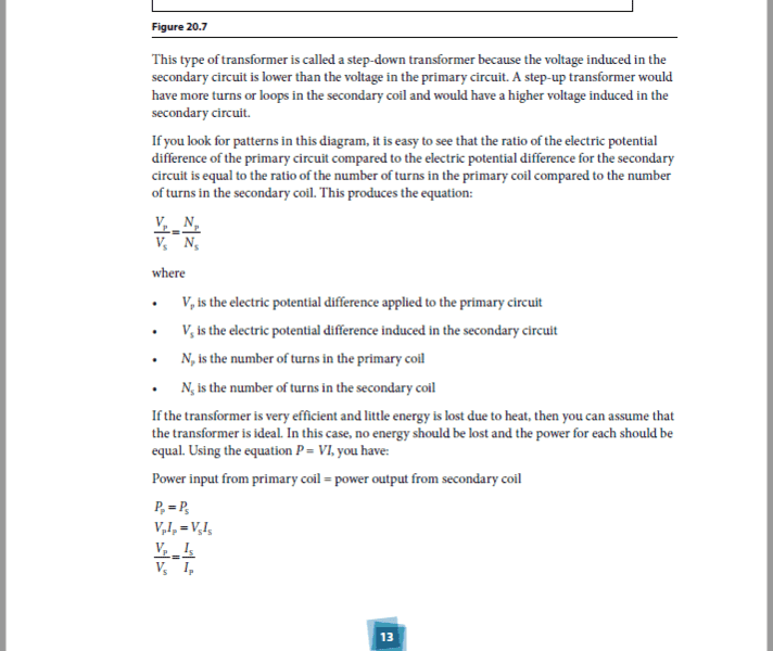

This is what my course said, does that change anything?
That is not the formula you used.in #1. Look carefully at the last line in your text and compare it with the first line of 3.1 in post #1.
Likes CAT 2
It does not change anything. It just confirms that Ip Vp = Is Vs, what I already had in post #7.
