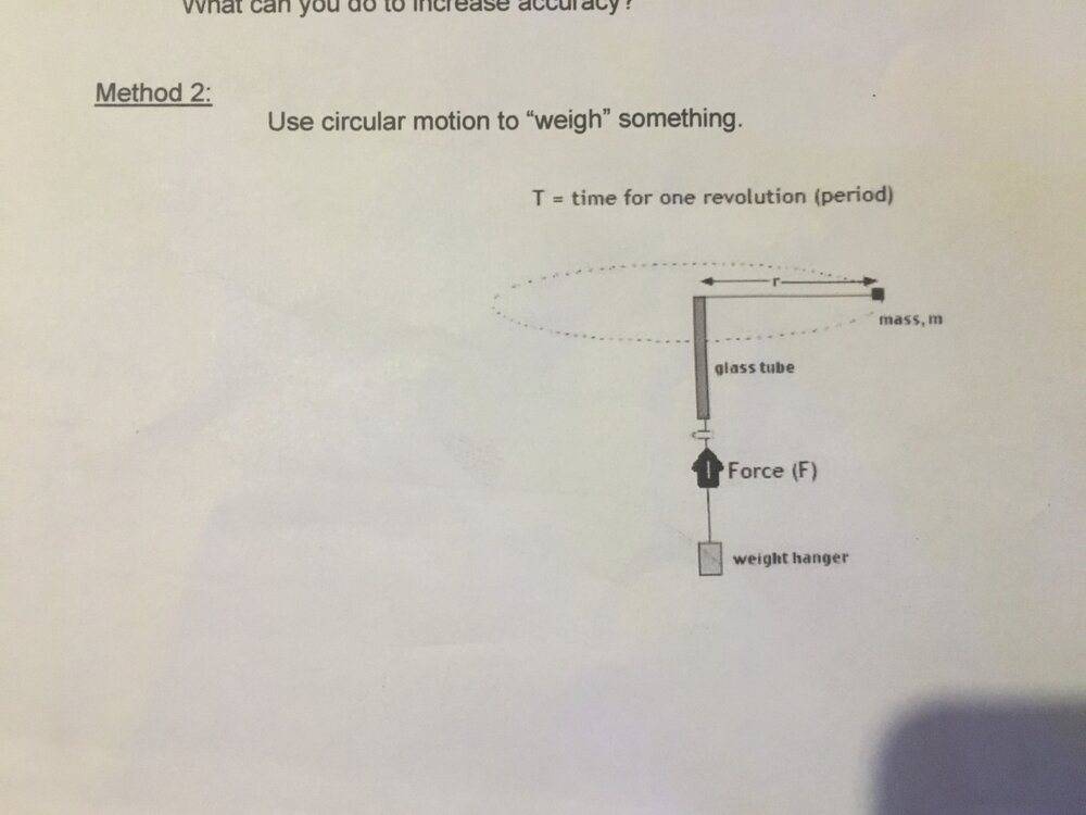

What is the correct formula I should use? (measuring g using a swinging mass)
In summary: I think it was 10. This is what I have gotten so far, I will fix the rest tomorrow once I've had some sleep.In summary, @MJNZ1 calculates the gravitational force between two masses by using two formulas, one for the weight hanger and one for the top mass, and finds that the force is 9.81ms^-2.
MJNZ1
What is the acceleration due to gravity?
Formula 1 F = (4pi^2*m*r)/(T^2)
Formula 2 g exp. = (4pi^2*m*r)/(M*T^2) or g = (4pi^2*m*r)/(M*T) ?
Hi,
This is my first post, I hope I have done it right.

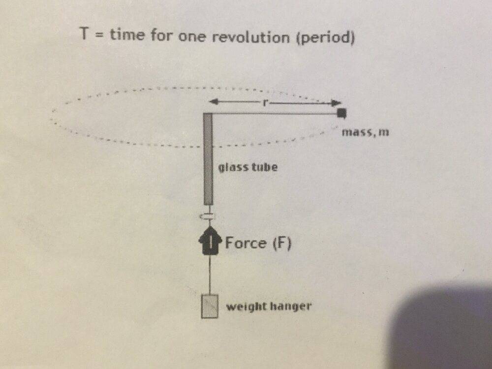

The top mass is represented as m and the weight hanger M.The image below is my attempt with the first formula 2. I have done it in grams because when I did it in kg's it was not anywhere near 9.81ms^-2...I know it is wrong :)
g exp. = (4pi^2*m*r)/(M*T^2) ...in kg's: (4pi^2*0.02*0.55)/(0.1*4.63^2) = 0.938ms-^2

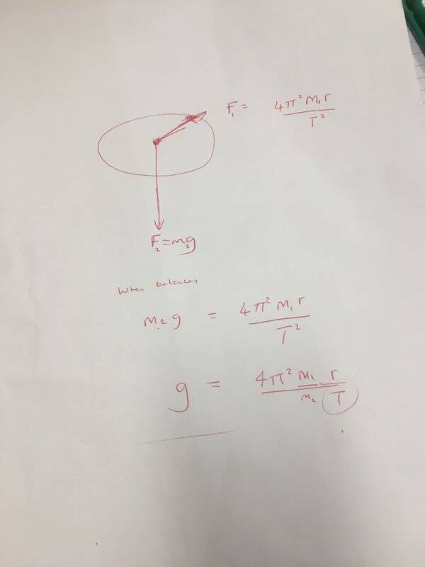

When the teacher was asked by another student for further help understanding, the second formula 2 was given.
This is my attempt at solving for gravity from the example below in kg's: (4pi^2*0.02*.55)/(0.1*4.63) = 0.938ms^-2
Likes Delta2
I am not very familiar with this type of experiment to measure g, but IF I have understood correctly the experiment, i think that the correct formula is $$g=\frac{F_c}{M}=\frac{m\omega^2 r}{M}$$ which becomes (after replacing ##\omega=\frac{2\pi}{T}##, $$g=\frac{4\pi^2mr}{MT^2}$$

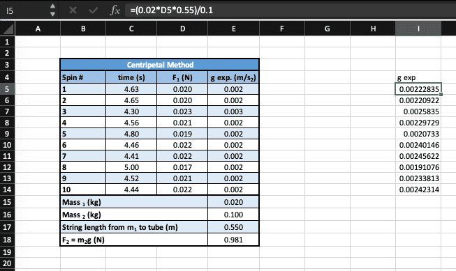

Thank you for your reply.
What is w? tried it as Newtons but it didn't work out so well, unless I've entered it in wrong?
In the screenshot of the spreadsheet, the cell formula has a 20 where there should be a pi(). This makes the computed values in columns F and K nonsense.
In the hand calculation, (4pi^2*0.02*.55)/(0.1*4.63) = 0.938ms^-2, the 4.63 should be squared, leading to an even lower value.

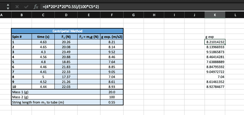

Oh, of course. Yes, I did, it was before our two-week break, so I had forgotten and didn't note down the number of revolutions. The 20 was for F1 because I mistook pi for F1 and hadn't changed.

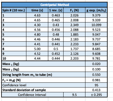

There was a slight gradient in the string, but it wasn't part of the criteria to calculate for this. I'm just in a basic pre-engineering course because I have been out of school for 16yrs, I guess they just want to keep labs simple at the moment. :)
Likes Delta2
The slope correction would lift the value of g by about 2%, which gets you usefully closer to the correct value.
What mean do you get?
How are you calculating the confidence interval?
Our teacher set us up a calculator in excel, I haven't done a mean...I desperately need some sleep, lol.
Looks like the 9.5 number is the mean. The +2% correction would get you to 9.7, so definitely more creditable.
The quoted confidence interval seems to be a bit over two standard errors of the mean. One standard error would be stdev/√(n).
Likes MJNZ1
Thanks, I will do the taught method first and if I get enough time I will also add the equation that you gave in question 4. I will fix up the confidence interval, thanks for checking that. :)
No, no need to change anything re the confidence interval. That depends on the level of confidence specified, and two standard deviations may well be what was chosen.
