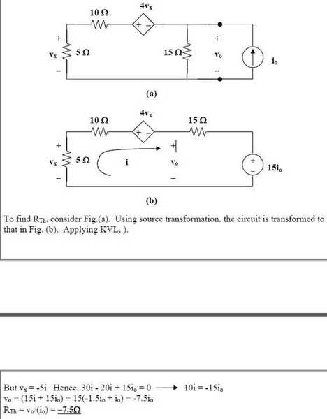

My question:
1) In diagram (b), is there a reason why Vo is to the left of 15 ohm resistor and not to the right? (which wouldn't produce the same answer) cf. diagram (a)
It might be a minor point but I'd like to know the specific reason
Thanks

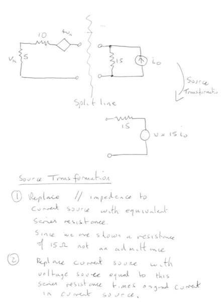

Does this help?
You have to have a parallel impedence to the current source to transform.
Working from right to left this is the 15 ohm resistor.
Ah I see it, thanks!
