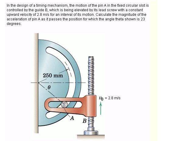

pls see attached file.
so i thought i could use this eqn:
aA = w2 AO en + alpha AO et
but when i try to work out w, something goes wrong. i do:
w = 7.16605 (normal velocity i found by having the given velocity as a y coordinate one, then resolving for normal/tangential) / 0.25. but this itself is wrong. what have i done? also how do i calculate alpha? i have no IDEA how to do it!
thanks a lot for ur help,
cheers,
s.
alpha is the angular acceleration, or the rate of change of w w.r.t. time.
Tell me if you get stuck.
yeh but how do i calculate it with the data given? we haven't been given an equation to differentiate to find alpha. also I am still stuck on calculating w.
w is the angular velocity, or the rate of change of theta w.r.t time.
If you find w as a function of theta you can differentiate w.r.t time.
You can find w as a function of theta by considering the component of the linear velocity of the pin which is perpendicular to AO.
