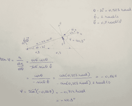

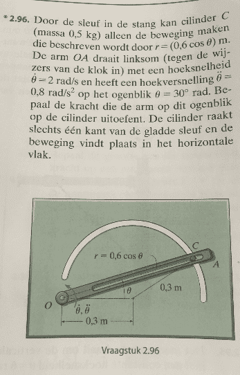

Calculate the force on the cilinder. You need the angle of the tangent and r.
Down under here. The solution for the angle is 30°. But why does the formula I used did not work out?
My solution is 40,9°, why isn't this correct for this excercise?
