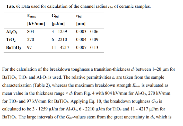

I've been researching dielectric breakdown for a while and came across this interesting experiment:
https://tore.tuhh.de/bitstream/1142..._nano_to_millimeter_scale_TUB_Doc_version.pdf
0.3mm of BaTiO3 was placed between two electrodes and reached its dielectric breakdown at 97kV/mm. At 0.3mm thickness this was probably around 29kV. I'm trying to understand what the current was, but so far I only know that a dc high voltage generator HCN 140-35000 with a current limit of 4 mA and a maximum voltage of 35 kV was used during the experiment. I'm not familiar with the relationship between μJ/m and current if there is one, but it's the only information on joules used I could see. Any assistance is greatly appreciated!
https://ieeexplore.ieee.org/document/38354
Expect negative resistance after breakdown. Apparently the current limit prevented avalanch breakdown. 35K at 4 mil was 150 Watts which is a pretty hefty high voltage source. Similar compounds used in voltage protection devices have an avalanche breackdown that drop line voltage to a few volts. Usually used for electronics capacitors, dielectric has problems at high voltage. (Dielectric is damaged before voltage breakdown.)
Likes HelloCthulhu
