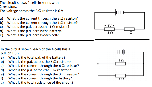

What is the current in this circuits?
In summary,HOMEWORK:-Ohm's Law: V=IR, Eel=VIt, Vt=ItRt, Q=It-The Attempt at a Solution: I tried to do the first question letter a, but I don't know how to continue the others. So far, so good, so long as you know what it is that you have worked out.-Your final line says, V=6V I=2A so now you know V,I and R for the 6Ω resistor.-So now, what do you know about the 3Ω resistor? So far, so good, so long as you know what

Ohm's Law : V = IR, Eel = VIt , Vt=ItRt , Q=It
I=? I= V/R
R=3 ohms I= 6/3
V=6V I=2A[/B]
i don't know how to continue the others :/
Likes CWatters

I don't know if I can work out b) without any given volts in the 2nd 1ohm resistor
What type of circuit is depicted? Is it series-connected or parallel-connected?

But you haven't said what you DO know about it!
I'll give you a start. You know R is 1Ω. Now, can you tell me what I or V is? (without doing any calculation yet.)
If you say you know neither I nor V, you could try drawing on the circuit, or think about gneill's question,. .Because you DO know one of them! And you only need 2 out of 3 to work out the other.
its connected in series meaning voltage is divided among components.
V - volts , I - current.

You need not know that.

What else does that mean? What about the current through the series components?
series same current

So then, what is the current through the 1 Ω resistor?

2A?

Yes. It's a series circuit so there is only one current.

Yes. So what is the voltage across the 1 ohm resistor?

for b) 2A
c) v=Ir
2x1=2volts

Yes. Now you have sufficient information to calculate the p.d. across the battery.

for d) is it 6V + 2V = 8V?
e) each cell has 2v?

Yes.

For the next problem,
a) 1.5x4 = 6V
b)
V?
R=6ohm
I= 1? (v/ohm,6/6)
6x1=6V?
c) 1A?

Yes.

d)
v=?
r=3ohm
i=2a(6/3)
v=ir 2x3 = 6V?
e)2A?
but how come can both be 6V when its a 6V battery?

What can you say about the voltage across two parallel components?

a i see constant pd

e) 2A
f) 2a+1a = 3A
g) 1/6 + 1/3 = 1/2 = 2A?

Yes.
) 1/6 + 1/3 = 1/2 = 2A ** ohm**?

my mistake.. its ohms.
