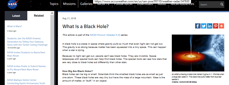

A black hole is a place in space where gravity pulls so much that even light can not get out
OMG, I saw that quote and thought, there's no way that NASA published that. It sounds like something from a kid's book or something. So I did a Google search on the quote, and sure enough it's from NASA:
https://www.nasa.gov/audience/forstudents/k-4/stories/nasa-knows/what-is-a-black-hole-k4.html
But if you look closely at the quote, you see it is targeted for K-4th grade kids. LOL, I was right! :smile:
