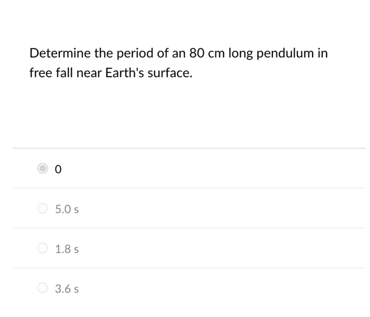

Determine the period of an 80 cm long pendulum in free fall near Earth's surface.
T=2pi*sqrt(L/g)
I put 0, but that is incorrect. Why is 0 an incorrect answer? This is confusing, as if the pendulum is in free fall, wouldn't there be no SHM at all?
What does your Relevant Equation evaluate to when you put the numbers in it?
Zero period means that if you displace it from the equilibrium position, it takes no time at all to return back. Does this make sense for a pendulum in free fall?

If the pendulum is in free fall, then ##g = 0## in its rest frame (which is accelerating relative to the Earth).
A pendulum which is supported at its fixed point is not in free fall. It is acted upon by a supporting force at its fixed point and therefore gravity is not the only force acting upon it.

OP put in zero for the answer and that is indeed an incorrect answer for the period when ##g=0.## For ##g=0##, one gets "infinity" for the period ##T=2\pi\sqrt{L/g}.## This agrees with observation. In free fall, or in free space, if one ties one end of a string to a bob, the other to a support (whatever that means) and gently displaces the bob, the bob will stay where it is. In other words it will take infinite time to return to its initial position.
To answer OP's first question, "why is 0 an incorrect answer?", zero would be the correct answer for the period if the length of the pendulum were zero. Then, if displaced from equilibrium, gravity or no gravity, the bob will take zero time to be returned to the equilibrium position because it's already there!
To answer OP's second question, as explained above, there is no SHM at the two limiting values of the period, zero and infinity. However, there will be SHM for any value of ##g## other than zero or infinity.

I am taking AP Physics 1, and currently on Unit 7 (Simple Harmonic Motion)
I have attached the problem statement and the possible answer selections below. "undefined" never appeared as one of the answer choices, so I picked 0 as that was the only other answer that 'made sense' to me.
And, considering it was in freefall, wouldn't there be no SHM at all? Which would effectively make the period of the SHM none, too?
It looks like a bad question to me. The third answer from the top would be the correct answer if the pendulum were not said to be "in free fall". Maybe the author has a different understanding of "free fall" from everybody else.

Well, if you delete "in free fall" from that question, one of the other 3 options is correct. Can you ask your instructor what "in free fall" means in this problem statement? Like "letting go" of the pendulum at a small initial angle maybe?
This will also make sense of the "near Earth's surface". If it is really in free fall it is a completely irrelevant addition to the statement.
More likely, there was some kind of editorial error made when the question was written. Perhaps a prior version contained that phrase and it was determined that there was no correct answer. So they decided to remove it and it never got removed in a latter re-write.
I bet that the grading algorithm would mark it correct if a student chose the third answer.
