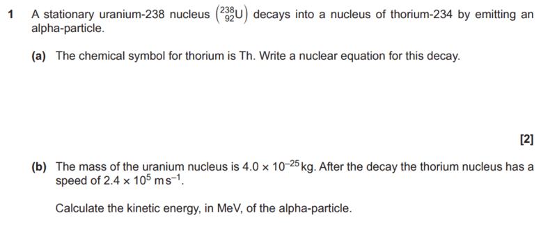

From what I can gather the electrons are taken into account when calculating amu. Finally I have one more question, In the following question the author subtracts the mass of the alpha particle from the uranium nucleus, to get the mass of the thorium nucleus. Is the author just blatantly ignoring the fact that the energy given out to the two products must come from a loss in mass of the system, which implies the sum of the masses is not constant on both sides of the equation (so you cannot simply subtract one from the other)?
The binding energy here is small compared to the masses of either of the daughter particles. At the level of precision (two sig figs) here, it is negligible.
If you saw this question on a test, what hints you towards ignoring the binding energy?
Be aware that allowing for nuclear binding energies will change calculated masses by less than 1%.
You can usually spot questions where binding energy needs to be taken into account because values of mass will be given to a fairly large number (e.g. 6) of significant figures.
Also, the nature/context of the question should guide you.
By the way, 'amu' is a bit outdated. A single 'u' is often used. But to be up to date, the name for this unit is the dalton (symbol Da).
