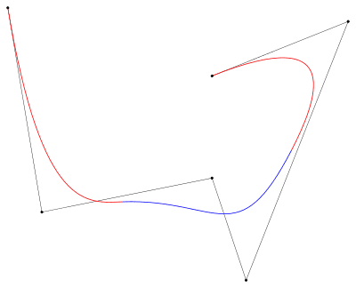

What exatcly does "pass through first and last point" mean? (Wondering)
That it looks like this:
In this example the B-spline starts at the first point and ends at the last point.
The B-spline does not pass through any of the other points. (Thinking)
