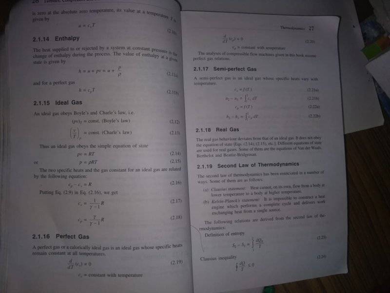

I am confused after reading. I don't know what it is trying to say.

According to the author your book, he defines a perfect gas as an ideal gas with constant heat capacity.

Now I am more confused. What is perfect gas?

I don't know how I can say this more precisely. Sorry. My advise is to not obsess over the difference, and to continue on with your learning.
