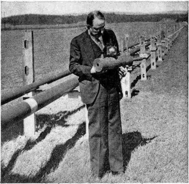

The first demonstrations of microwave transmission through waveguides were performed around 1930 by G. C. Southworth. He used round copper rain downspouts one mile long visible in the photo below.
Southworth at Bell Labs in 1943 standing in front of experimental waveguide line he used in his original research into waveguides during the 1930s. (Wikipeadia)
As tech99 pointed out, however, round waveguides mix modes and polarizations, as do imperfections in rectangular guides. It's also true that pipe joints give poor electrical performance unless they are carefully soldered or welded. Commercial waveguides, on the other hand, have flanges with built-in quarter wave chokes that provide nearly lossless performance in a bolt-together joint.
