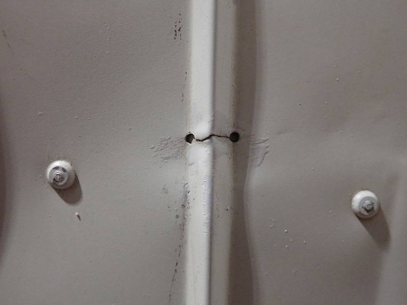

Here's a photo of a fracture that is not a failure:
It's in the elevator of a Cessna 172. The holes at each end are stop drills for the purpose of preventing the crack from spreading. It's an old crack, at least several years old. If the crack was to spread too far, then it would be necessary to replace the panel. As it is, neither I nor the A&P-IA is concerned about it. But we are keeping an eye on it.

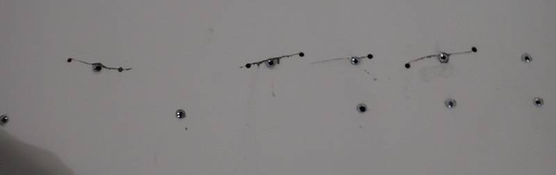

Here's a photo of several fractures that are spreading:
It's from the wing skin from a different Cessna 172. This wing skin was removed and replaced because three of the cracks spread beyond the stop drills. The A&P who replaced it is not the one that signed off on it a year ago. This mechanic would probably have replaced it before it got this bad.
