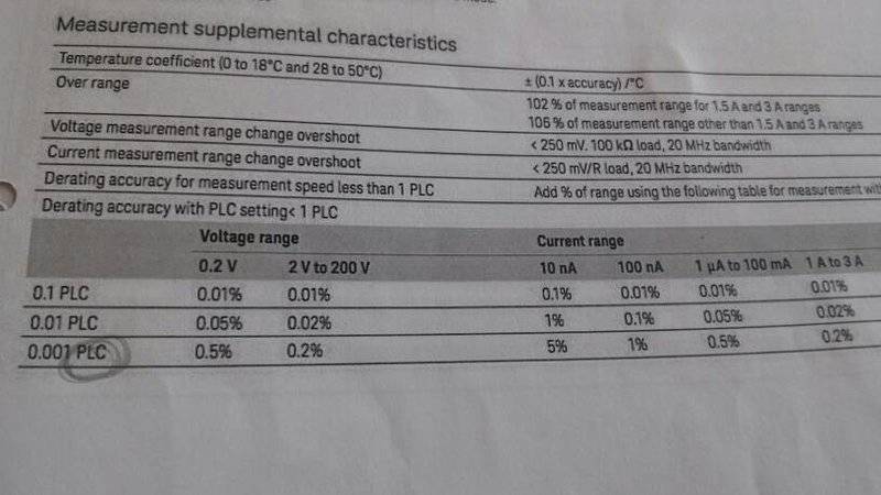

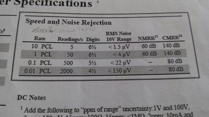

I found these tables in a datasheet. I do not understand difference between PLC and PCL. I know that PCL shows time when the instrument integrates on the useful signal but i would like other definitions of both of them
Please stop making us guess what you are asking about. What is the instrument? Can you provide a link to the soft copy of the datasheet (like at the manufacturer's website)?
Could be typo?
houlahound said:
Could be typo?
Doing OP's job for him:
http://www.tek.com/sites/tek.com/files/media/media/resources/1KW-61135-0_2015_Datasheet.pdf page 8. Note the correction.
