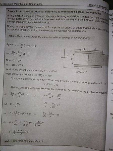

Here's the derivation. Its not in the coursework (this is extra work I'm doing for fun, and a little more knowledge and so its above my understanding in many ways) Can someone just specify the direction of the force found?

Seems to me that the force is perpendicular to the (supposedly parallel) electric field between the plates. I reach to this conclusion because I see that work equation , the work of the force is taken to be ##Fdx##, so we have to assume that the force is parallel to dx.( there is no ##\cos\theta## or ##\sin\theta## term involved).
But I can't explain the exact inner workings of interaction between the electric field and the dielectric that make such direction of the force possible.

In the derivation that you posted, note that the expression for the work done on the dielectric by the externally applied force F is -Fdx. This implies that F is taken to be positive when it acts toward the right in the diagram. (This is a little tricky. You also have to note that dx is positive when the dielectric moves to the left.) Since the final answer for F comes out positive, the direction of the external force on the dielectric is to the right. This force balances the electrical force on the dielectric. So, the electrical force is toward the left. That is, the electrical force pulls the dielectric into the region between the plates.
The physical reason for the existence of the electrical force and why it has the direction that it does can be traced to the fringing of the field in the regions near the left and right edges of the capacitor. For example see http://te.fisica.edu.uy/fuerza_en_Capacitor.pdf (especially starting on page 4).
