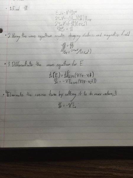

I found -dB/dt with the wave function, took the derivative of E = E_0 cos(k(x - vt)), got dE/dx to be -.5*k*E_0.
Set them equal, solved for E_0, and got (-dB/dt * lambda) / Pi.
I then set the poynting vectors equal so P_tran / (2Pid^2) = E_0^2 /(mu_naught * c * 2), which when solved for r is
d = ((P_tran * mu_naught * c)/(Pi * E_0^2))^(1/2)
I ended up with a value or arbitrary units, no where near what it should be.

.5 gives the average of the sinusoidal function.
E_0 = (V*lambda)/(Pi^2*r_ant^2) (according the my calculation of using the wave equation to derivate E_0).
The size of the antenna is used in E_0, because you're calculating the induced voltage through the loop.
The units are consistent until the very end when i set there Poynting values equal to each other and solve for d.
Is my 4th step correct, before I continue? Hopefully everything is clearer now though!

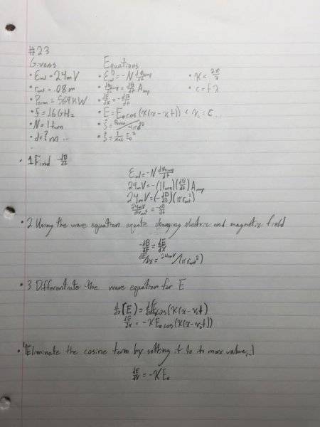

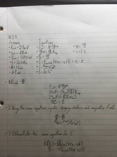

Sorry, that came out a lot less clear than I wanted.
If you sill can't read it I'll upload it to imgur or drop box or something.

I see what i did, I didn't square V/m. Ok, back to business then, is my 4th step correct, or no?
Hmm, nice relation with ##\mu_0 c##.
Where did you square E_0?
The units were stupid on my part! The problem is still knowing what E_0 is though.
dE/dx is right, the relationship to E_0 is the last missing step. And it is just a constant factor you have to fix.
So, are you saying dE/dx = -κ* Eo is incorrect?
For all of those in the future who come seeking a solution, this is it.
keep going from where i left off, plug and chug by setting energy flux of the transmitter (P_tran / 2 Pi d^2 ) equal to (E_0^2 / 2 mu_0 c).
Then solve for d!
