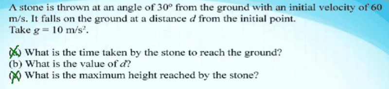

What is the distance traveled?
In summary, the conversation discusses using equations to solve for the distance and time of flight in a projectile motion problem. The equation given in the homework is used to find the distance, but the person solving the problem mistakenly used a simplified version of the equation, leading to an incorrect answer. After realizing the error, they corrected it and arrived at the correct solution of 180√3 meters.
prakhargupta3301
58
Only (b) part[/B]
time of flight= (2⋅u⋅sinθ)/g ---------------- - 1
total distance (range)= u⋅cosθ * time of flight (s=vt)
=u⋅cosθ * (2⋅u⋅sinθ)/g --------------- -2
=u2⋅2sinθcosθ/g
= u2⋅sin2θ/g ---------------- -3
[/B]
Rather than using equation 3, I decided to use 2, as 3 is just 2 simplified.
Distance= u⋅cosθ * (2⋅u⋅sinθ)/g
= (60*cos30°)*(2*60*sin30°)/10
= (60*(√3/2))*(2*60*(1/2))/10
=(30*60√3)/10
=180√3 metres
However by equation 3,
Distance= u2⋅sin2θ/g
= 3600*(sin30°)2/10
= [3600*(1/4)]/10
= 900/10= 90 metres.
Where is the error please tell me!
THank you for reading.
2sinxcosx = sin(2x) whereas you are using sin2(x)
You should get 180√3 either way.
Likes prakhargupta3301
Thanks a bunch. I redid the mistake over and over again.
Now it's clear.
:D
