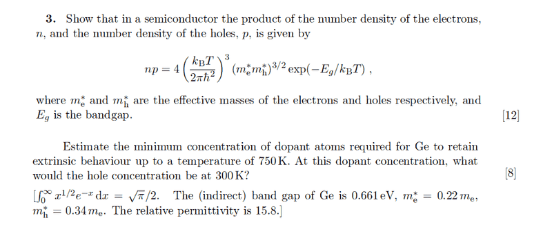

What is the doping and hole concentration?
In summary, the conversation discusses the show law of mass action and finding dopant concentration and hole concentration. The equations and solution for finding the concentrations are also shared, along with a discussion of the estimated doping concentration at different temperatures.
unscientific
1,734
(a) Show law of mass action.
(b) Find dopant concentration and hole concentration.[/B]
Part(a)[/B]
Bookwork.
Part(b)
Letting the doping concentration be ##D##, we have:
[tex]D = n - p[/tex]
For ##I = n_{intrinsic} = p_{intrinsic}##, we have:
[tex]D^2 + 4I^2 = (n+p)^2 = (n-p)^2 + 4np[/tex]
Which gives us the result
[tex]n = \frac{1}{2}\left( \sqrt{D^2 + 4I^2} + D \right) [/tex]
[tex]p = \frac{1}{2}\left( \sqrt{D^2 + 4I^2} - D \right) [/tex]
For the doping to work at 750K, I estimate the doping concentration to be ##D \approx n_{intrinsic} = \sqrt{np}##.
At 750 K,
[tex]D = \sqrt{np} = 1.7 \times 10^{23}[/tex]
At 300K,
[tex]I = \sqrt{np} = 1 \times 10^{19} [/tex]
Since ##D >> I##, we have
[tex]p \approx \frac{I^2}{D} = 6 \times 10^{14} [/tex]
Is this right?
