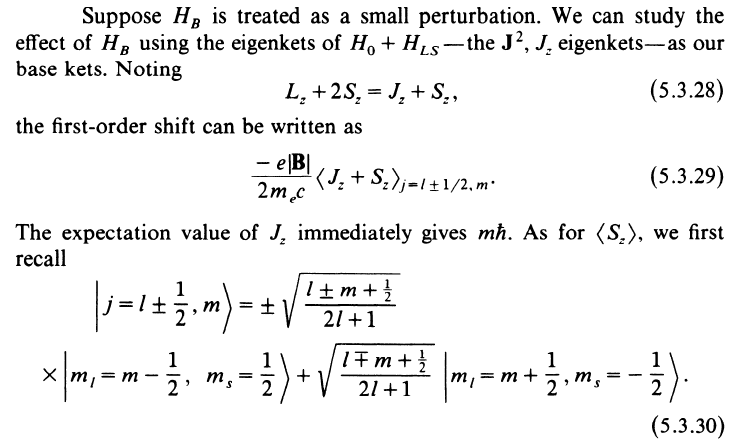

In the calculation of the Zeeman Effect, the most important calculation is
[tex]\langle L_z + 2S_z \rangle = \langle J_z + S_z\rangle[/tex]
Suppose we want to find the Zeeman Effect for ##(2p)^2##, meaning ##l=1##.
In Sakurai's book,
My question is, what is ##m##? They say that ##m## is the eigenvalue of ##J_z##, meaning ##J_z = l + m_s = \frac{3}{2}## in this case.
Using ##m = \frac{3}{2}##, it gives the wrong Gordon-Clebsch coefficients.
I have worked out the correct form, which is adding orbital angular momentum ##(l=1)## to its spin ##(\pm\frac{1}{2})##
[tex]|l + s, m_l + m_s\rangle = |\frac{3}{2},\frac{1}{2}\rangle = \sqrt{\frac{1}{3}}|1,1\rangle|-\rangle + \sqrt{\frac{2}{3}}|1,0\rangle|+\rangle[/tex]

my biggest problem is, they say that the eigenvalue of ##J_z## is ##m##, but then ##m = \frac{1}{2}## gives the correct gordon-clebsch coefficients. Does this mean that ##J_z = \frac{1}{2}##? But isn't ##J_z## the TOTAL angular momentum? Shouldn't it be ##J_z = l + s = \frac{3}{2}##?
##J_z## is the z-component of the total angular momentum. It can take on any value from ##j## to ##-j##. According to the rules about adding angular momenta, ##j## can take on any value from ##l+s## to ##\lvert l-s \rvert##.
you seem to be confusing l with ml and s with ms. If l = 1 than ml = -1, 0, 1 are all possible, and if s = 1/2 than ms = +1/2 and -1/2 are possible. m = ml + ms

If that's the case, then for ##l=1## and ##m_s = 1##:
[tex]|l + s, m_l + m_s\rangle = |\frac{3}{2},\frac{1}{2}\rangle = \sqrt{\frac{1 - (1 + \frac{1}{2}) + \frac{1}{2}}{3}}|1\rangle|-\rangle + \sqrt{\frac{1 + (1 + \frac{1}{2}) + \frac{1}{2}}{3}}|0\rangle|+\rangle[/tex]
These coefficients are wrong.

For the state ##\left\lvert \frac{3}{2},\frac{1}{2} \right\rangle##, you have ##j=3/2## and ##m=1/2##. In your expression for the coefficients, you're using ##m=3/2##, which is why they're not coming out right.
Likes 1 person
Damn, I should have been more careful. Thanks alot!
