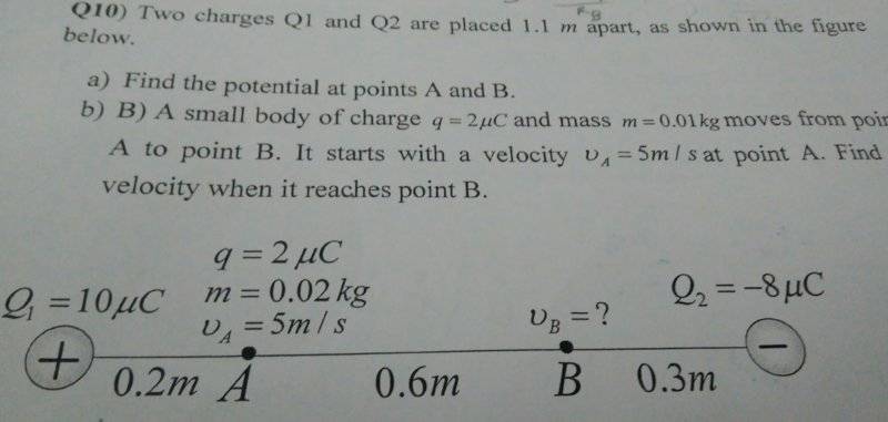

What is the electric potential at points A and B?

They're in the attachment
V=kQ/r
I was absent during this class,so I have no idea,but I attempted question a which is the potential at point a,b
Point a=(9*10^9 * 10*10^-6/0.2)
Point B=(9*10^9 * -8*10^-6/0.3)

Don't you think the potential at a given point would be a function of all of the charges?
The potential is a scalar quantity. Simply find the potential due to A, the potential due to B, and add them up. Here is an algebraic solution:
We know that ##V = \frac{kQ}{r}##. So, ##V_A## will be given by $$V_A = \frac{kQ_1}{r_1} + \frac{kQ_2}{r_2}$$, where ##r_1## and ##r_2## are the distances between the point charges. Do the same for part B.
