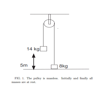

See the masses in Figure (1) which start out at rest. (i) Find the velocity of the 14 kg mass just before it hits the ground. (ii) Find the maximum height reached by the 8 kg (and don’t worry about hitting the pulley). (iii) Find the fraction of mechanical energy left when the system finally comes to rest.
1) Newtons laws
2) Energy Conservation
i) I first analyzed the forces as soon as the 14 Kg is released. The aim of this step is to calculate the work done by the net force acting on the 14 kg mass to determine the change in kinetic energy.
T-14g=-14a
T-8g=8a
T=99.7 N a=6g/22 m/s^2
Since the net force is constant and does not vary with distance
K2-K1=F*distance travelled=-37.418*5=187.1 =1/2mv2^2
K1=0 Since the system starts at rest. solving for v2
v2=5.169 m/s
When the system was at rest, was there an external force pushing down on the 8 kg mass to counter what the tension force wants to do. Similarly, another external force acting on the 14 kg mass to hold it at 5m off the ground. At the point of release, these external forces are removed. I am not sure of my reasoning.

Consider that gravity is acting on the whole system at once, as both masses are linked by a string of constant length.
Yes, absolutely. There had to be some upward external force holding the 14 kg mass or pushing the 8 kg mass down else heavier mass would move downwards. But this external force is of no consequence when the heavier mass starts moving down from rest since at that point of time the external force is not there.

i) The two external forces acting on the system are the weights of the two masses. Since 14g>8g the system will accelerate in the direction of the heavier mass. a=14g-8g/14+8=6g/22. T=14g-14(6g/22).
Energy of the system
Change in kinetic energy of the system is equal to the work done by the net force acting on the system. The initial kinetic energy is zero since the system is at rest, the final kinetic energy is 1/2(14+8)v^2. The net force is 6g. The displacement is 5 m.
1/2(14+8)v^2=6g*5 v=5.169 m/s

From that assumption if the 14 kg mass moves down 5 m the 8kg will move up by the same 5 m. If the displacement is the same so is the velocity and the acceleration.
ii) The 14 Kg hits the floor, a normal ground force acts on to stop it from accelerating. That normal force is the difference between its weight and the tension of the rope. For the 8kg mass the forces acting on it is the pull of gravity (8g) and the tension of the rope pulling it upwards, why does it come to a halt as it reaches its maximum height there must be an additional force that decelerates it.

When heavier mass hits the ground then its KE i.e kinetic energy is dissipated as sound and heat energy and it can be assumed to come to rest. Then the lighter mass experiences no tension since the string now will not remain taut as lighter mass will continue moving up under gravity acceleration to a max height where it's velocity will be zero.
Likes Vigorous and Lnewqban
The string can only work in tension, not in compression.
For that reason, the 8-kg mass "can't feel" that impact force that stopped the 14-Kg mass.
It only "feels" the sudden absence of the 14g force that was pulling it up, but it "feels" no resistance to continue moving up as a projectile as far as gravity will allow it to go (its accumulated kinetic energy will be transformed into potential energy.
Then, the 8-kg mass will be in free-fall until impacting the ground, just like the 14-kg mass did a little before.
As the 14-kg mass does not affect the system after impact, we should not be concerned with the type of impact (elastic or not) or the forces involved in it.
Same for the 8-kg mass during and after impact.
Likes Vigorous and vcsharp2003

When the 14 kg mass hits the floor why does the tension equal to zero? I understand why the tension after the impact cannot equal its value just before the impact then the 8 Kg mass would continue to accelerate upward. It would be speeding up and gaining height and would result in having more energy than what it started with. Why isn't the tension equal to some value less than the weight of the 8kg? Why does the normal due to the ground have to support all of the weight of the 14 kg and not share part of it with the tension force?
-8gh+8g(5)=K2-K1=-1/2(8)(5.169)^2
K2=0 at the maximum height
K1-kinetic energy of the 8 kg mass at 5m off the ground
The smaller mass has an upward velocity, so it will continue up for a distance. The larger mass has stopped descending. Therefore the string is slack and does not exert any force.
Or are you thinking that the tension could be zero on one side and not on the other?

Using energy you do not need to find the tension or acceleration.
I strongly recommend ignoring the given numbers and working entirely symbolically until the end. Write M for the larger mass, m for the smaller, h0 for the initial height.
The simplest way is:
Loss of PE =(M-m)g.h0.
Gain in KE = ½(M+m)v2.
##v^2=2gh_0\frac{M-m}{M+m}##.
We need to move on to the next phase. What happens after M hits the ground?

For each mass, there is tension in the string, so there is work done by the tension in each mass. Energy conservation of mass M: The work done by the bigger mass M is positive because the block is moving in the direction of Mg. The Work done by Tension is negative because the block is moving counter to the direction of tension
1/2Mv2^2+Mg*h2-T*h2=1/2Mv1^2+Mgh1-Th1
h2=0 h1=5 v1=0
Why is this formulation of the conservation of energy for mass M incorrect?
I think you are taking the heavier mass as a system and the smaller mass as another system. But the recommended solution considers the two connected masses and pulley as a system, in which case the tension is an internal force and not an external force. Internal forces are to be ignored when applying conservation of energy law. So, tension is ignored in the recommended solution. Only external forces are to be considered when applying law of conservation of energy to a system.
I got you! The work done by the tension of the rope which influence the motion of the masses m and M cancel each other. The string is inelastic, if M moves down by 5 m, m will move up by 5 m.
Energy conservation becomes:
Mgh0+mg(0)+1/2M(0)^2+1/2m(0)^2=Mgh0=Mg(0)+mgh0+1/2mv^2+1/2Mv^2 => gh0(M-m)=1/2v^2(M+m)
v=(2gh0(M-m)/(M+m))^1/2=5.169 m/s
The heavy mass hits the ground, its kinetic energy is transformed into another form of energy (heat or sound). The system will try to stay in motion at 5.169 m/s. The string connecting the two masses is no longer stretched because the weight of M is compensated by the reaction of the floor, M stays at rest. T no longer acts on m. m will uniformly decelerate with initial speed of 5.169 m/s
mgh0+1/2mv^2=mgh
h=6.36 m

mgh0+1/2mv^2=mgh
h=6.36 m
For part iii, final rest position will be with lighter mass at 5 m position and heavier mass on ground. This final position will be reached after multiple up and down motions of lighter and heavier masses. The impulsive force on heavier mass will lift it for each such motion, but this impulsive force will lessen after each impact of heavier mass with the ground till it's no more there. You can see that each impact of heavier mass with ground will result in dissipation of energy. At final rest position you would be left with only PE of lighter mass i.e mgh as the final total energy of the system.
