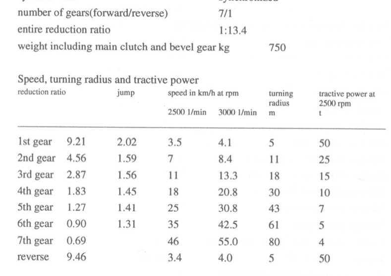

Here's the gear ratios of the vehicule (attached file, first column)
Final Drive : 8.4:1 or 1:8.4, I have two contradictory source.
How do I get to 1:13.4?
If it is just a multiplication of data I already know, I won't use it in calculus, but can you confirm with the data I gave this is that?
Thanks a lot for details anyway! I know now it is a reduction ratio grouping multiple gear (a whole gear system) and no just one gear
Looking at your data, it seems to be the range for the gear ratios of the gearbox. The first gear is 9.21 and the last one is 0.69, thus 9.21/0.69 ##\approx## 13.4. This means that you can cover the same speed/torque range than with a transmission with first gear 13.4 and last gear 1 (you would only need a different final drive).

Do you know the meaning of that "Jump" in the picture you have posted above?

No, I don't know the meaning of jump, I was probably going to be my next question. There is no other information on this jump column on the sheet paper (I'll share all the data I have as attached file), so if anyone knows about it, feel free to help us.

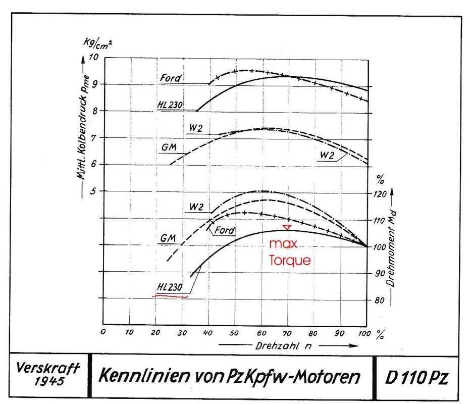

I also have a graph with the Pme of the engine (RalDhFY), allowing to calculate the torque (4 stroke engine, 23095cm^3 of engine dispacement), which revealed to be 8% lower than the real value (but I had only one value unfortunately, it doesnot mean that much). I included it aswell, it might help. The 100% of the bottom correspond to 3000rpm (and so 70% is 2100rpm), Drehzahl is rpm and Dremoment is torque (but I did not tried to read that graph, the % unit for Torque scrared me, so if you know how to read it...).
Same thing as "entire reduction ratio", but for one gear to the next.
$$\frac{9.21}{4.56} = 2.02$$
$$\frac{4.56}{2.87} = 1.59$$
$$\frac{2.87}{1.83} = 1.56$$
$$\frac{1.83}{1.27} = 1.45$$
$$\frac{1.27}{0.90} = 1.41$$
$$\frac{0.90}{0.69} = 1.31$$
$$2.02×1.59×1.56×1.45×1.41×1.31 = 13.4$$
