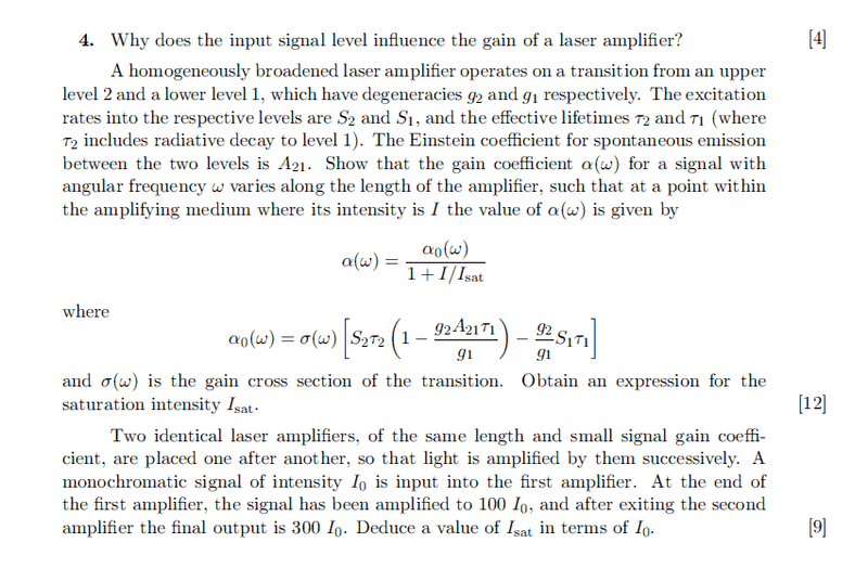

(a) Why does input intensity affect gain?
(b) Derive the expression
(c) Find saturation intensity in terms of input intensity
Part(a)
Consider a narrow band radiation as an input, where its bandwidth is much smaller than the spectral with of transitions, so in general
[tex]\frac{dN_2}{dt} = S_2 - (N_2B_{21}-N_1B_{12}) \int g_H(\omega - \omega_0) \rho(\omega) d\omega + \cdots[/tex]
[tex] = S_2 - N^{*} \int B_{21} g_H(\omega - \omega_0)\rho(\omega) d\omega + \cdots[/tex]
[tex] = S_2 - N^{*}\sigma_{21}(\omega_L - \omega_0) \frac{I}{\hbar \omega_L}[/tex]
Thus, we see that rates depend on input intensity ##I_T##, which influences the gain on a laser amplifier when we solve for the steady state solutions.
Part(b)
Bookwork. Managed to derive it.
[tex]\alpha(\omega) = \frac{\alpha_0(\omega)}{1 + \frac{I}{I_{sat}}} [/tex]
where saturation intensity is ## I_{sat} = \frac{\hbar \omega_L}{\sigma_{21} \tau_R}## and relaxation time is ##\tau_R = \tau_2 + \frac{g_2}{g_1} \tau_1 (1- \tau_2A_{21})##.
Part(c)
The equation for intensity is given by
[tex]\frac{dI}{dz} = \alpha I = \frac{\alpha_0}{1 + \frac{I}{I_{sat}}}I[/tex]
which may be integrated to give
[tex] ln \left( \frac{I(z)}{I_{(0)}} \right) + \frac{I_{(z)} - I_{(0)}}{I_{sat}} = \alpha_0 z [/tex]
At low intensity where ##I_{(z)} << I_{sat}##, the equation becomes ##I_{(z)} = I_{(0)} = e^{\alpha_0 z}##.
At high intensity where ##I_{(z)} \approx I_{(0)}##, the equation becomes ##I_{(z)} = I_{(0)} + \alpha_0 I_{sat} z##.
Thus initially the beam intensity is weak, then it becomes strong, so
[tex]e^{\alpha_0 z} = 100[/tex]
[tex] 200I_0 = \alpha_0 I_{sat}z[/tex]

For part (c) build two different equations, each of which relates the output intensity, input intensity, and distance (hint: you have derived this equation). Then to each one of them, input the different conditions, one is for after traveling the first amplifier and the other after traveling both amplifiers. It's then straightforward to derive the expression for the saturation intensity in term of only input intensity.
Likes unscientific
blue_leaf77 said:
For part (c) build two different equations, each of which relates the output intensity, input intensity, and distance (hint: you have derived this equation). Then to each one of them, input the different conditions, one is for after traveling the first amplifier and the other after traveling both amplifieTrs. It's then straightforward to derive the expression for the saturation intensity in term of only input intensity.
You absolutely right. I have been making unnecessary approximations. Solved this question.
