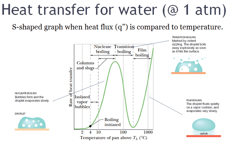

How are you heating the water? As you approach the boiling point, steam bubbles can form on the surface of the heating element, insulating the heater from the water and vastly reducing the heat transfer rate. This phenomenon is called nucleate boiling.
